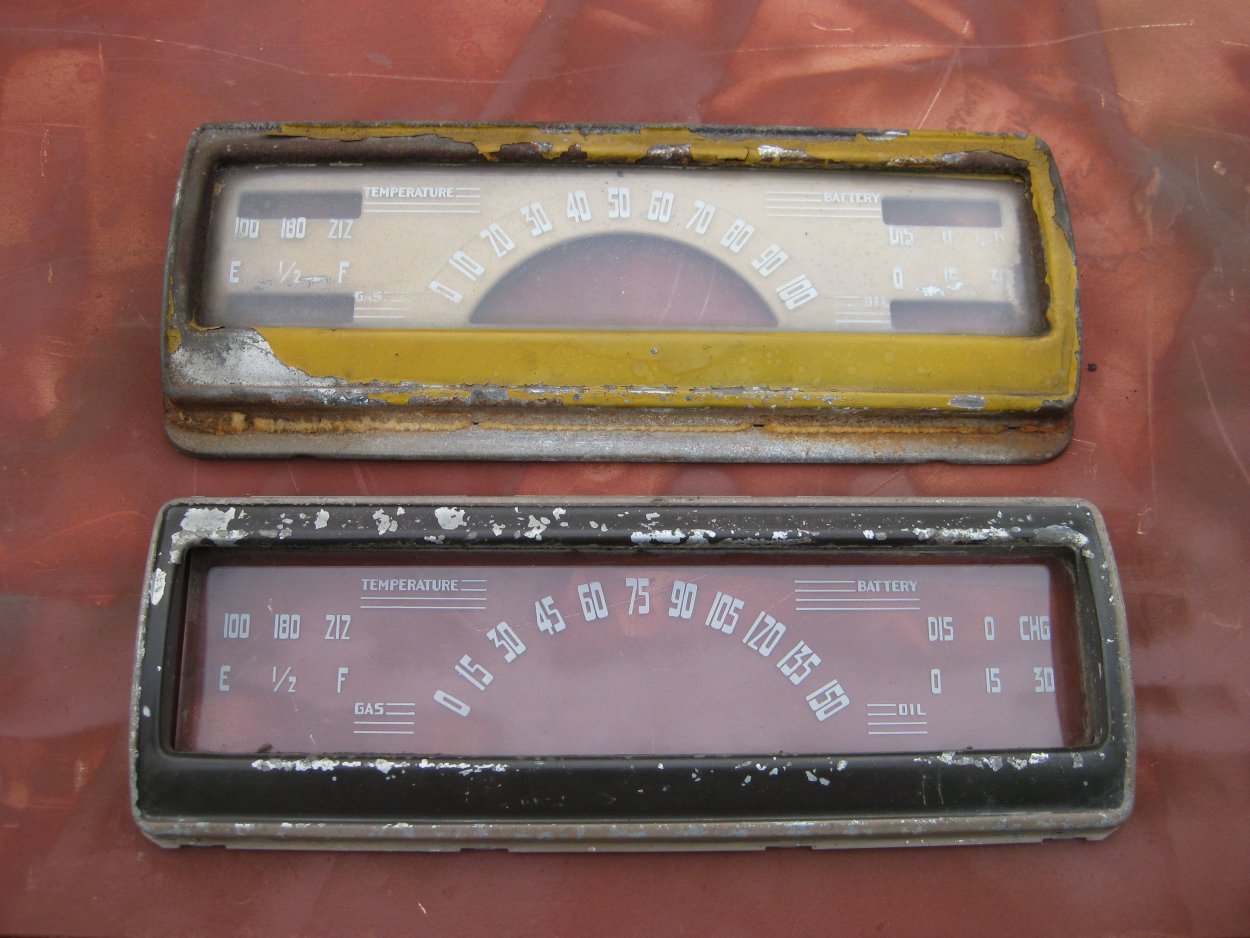

A while ago I bought a replacement gauge cluster in order to use parts from this and my original C8 gauge cluster (which is in a very sorry state) to get one complete set.....but look at the speedo range....
is that possibly meant to be 150 metres per hour Alex? After all it is a Chev LOL!

The 100 MPH reading on the original speedometer scale equates to 160 KM Per Hour which is pretty close to the maximum of 150 on the proposed replacement.
It is obviously a metric instrument face. The odd part is the temperature scale appears to be Fahrenheit.
Hell no! I'm not that old!
Well Cliff....it's still just a chassis with a front axle and pedals.....so 150 metres per hour sounds like an achievement
Exactly David. I was hoping it was just the face that was different, but have since found out that the speedo itself is also different and reads "KILOS" on the face. I will try to post a picture tonight.

Attached are some picture of the gauges that came with my replacement dash.
hmmm....just realised that the difference in kilometer vs miles speedo might not be in the actual range of the speed displayed on the face, but more the total miles/km's on the clock(?)....would that make sence?
