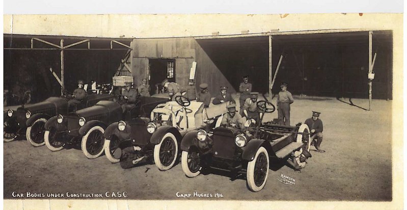

I am attaching some photos of the MT section in Camp Hughes, and their conversions. It would appear they liked to use model T cab and chassis. There are some vehicles in the background, including one ambulance that seems to have the hood of a Cadillac.
These photos came from Grant Tyler, who has been part of the Camp Hughes Conservation group for as long as I can remember.
Car bodies under construction.jpg   CASC Motor Repair Shop.jpg   CASC on Parade.jpg

Old 29-04-16, 13:29
Hi Rob, not a Model 'T' to be seen in any of the 3 photos. I am not sure what the chassis are, but hazarding a guess, I would say that they are the Hudson 1/2 ton chassis based on the Hudson Super Six. That chassis was used for passenger cars, ambulances and as troop carriers carrying up to 8 troops.
Regards Rick.
Old 29-04-16, 14:21
Posts: 7,613
Thanks for the information Rick. These older vehicles are way outside of my normal scope of interest, so I have a lot to learn.

Old 29-04-16, 20:04
Posts: 7,613
Regards Rick.
Was just looking at 1916 Hudsons on google and the radiator does not seem the same. In the one photo you can see a partially assembled truck where it looks like the military is actually building the cowl. It will make it much harder to identify the vehicle if that's the case.
If there is an old car guy who wants to take a stab at IDing the vehicles, I can email a higher resolution photo that can be increased in size to help identify.
IDing those trucks is a bit of a red-herring in all this, but since camp Hughes is only a half hour from here it will still be good to know.
