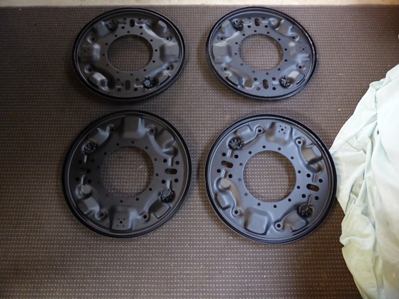

Hi Lynn and Rick,
Thanks for the replies.
Lynn - yes, that is a good idea on the cones. I made an attempt to get one out by welding a bead around it but it proved stubborn anyway, so will wait until after the blasting before I have another go. I have kept what was left of the gaskets and will make sure I use the same thickness.
Rick - yes, I found exactly the same thing with molasses. As you say, despite a bit of cleaning, there is certainly some junk left in the housings, so I think the media blasting will be the way to go.
There are a couple of broken brake line cover bolts in the top of the axle housing which I’ll remove and then tidy up the holes. I’ll also need to free up the drain/filler plugs, as these are all frozen in place. Once I have them sorted, I’ll drop the axle housings and diff assembly off to the blasters.

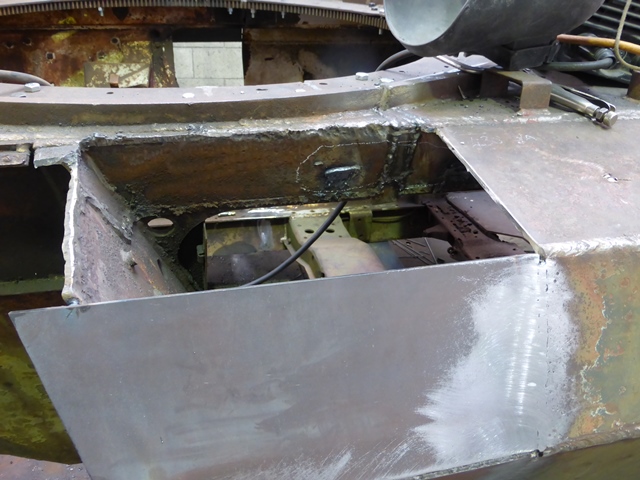

A few more pictures of further progress on the hull today. We are getting there. The panel joints on the sponsons will just need a bit of fibreglass to really smooth them out.
Once all the plates are in place, the original welding beads will be replicated to give it the proper finish.
A question - the steel channel that was welded into place at the top of the sponsons and runs the length of the upper part of the sponson (you can see the outline where it was cut away); does this serve any other purpose apart from structural support? I wondered if cabling went through this channel but the welder who cut it out said there were no holes in either end.
Can anyone confirm please?

Hi all,
This is starting to look like an M8 now. With the exception of some tidying up here and there, the hull repair is basically done. It came out really well and I'm glad we chose to do it this way.
Most of the welding work was done using a stick welder. The main exterior welds on the sponsons look very similar to the original welds and will just need a dab on the odd spot to really finish them off.
