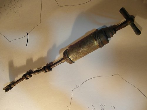

In the photo of the limbers spares box there is a small brass grease gun with what appears to be a hose. What fitting is on the end? (button head fitting?)
I have a small supply of similar grease guns but they have a metal pipe end with a couple of flexible knuckles on it, ending in a small button head fitting.
Is this a correct grease gun fora 25 pounder or other (17 pounder ) guns? Will attach a picture if I can get it to work....BP

Your gun looks correct, but I cannot say I have seen that hose before.
Here is the standard 25 pdr grease gun courtesy of the Irish Army.

Thanks Rob, my gun says Tecalemit London, cast in the body and appear to have a button head fitting that is smaller than the standard UC fitting. Does your have a rubber or woven metal hose?? BP

It is woven metal over rubber. We actually have about 25 of them at the museum. The majority are like this, then there is the odd variation with rubber hose.

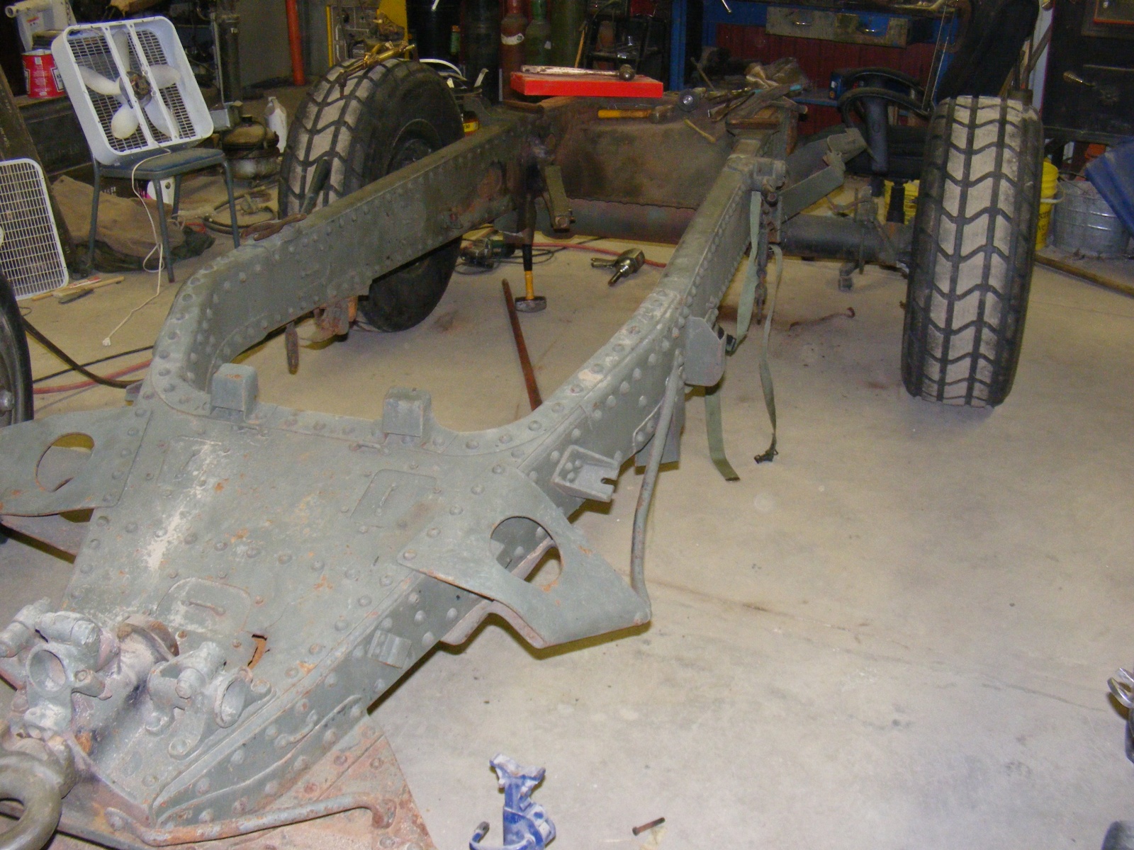

Thought I would toss a couple photos for an update. With the impending return to work (the Covid threat is low around here right now), I decided to take advantage of the weather and get some sandblasting and painting done. I had the basic carriage repaired and painted last fall, so this spring's work included the hubs and brakes, the traverse and elevations mechanisms, and the barrel. The barrel had been cut in it's previous life and reasonably welded closed again. I filled a lot of the small holes with mig, and profiled it as best I could. You can see the area if you look for it, but it doesn't jump out at you.
Everything gets sandblasted and POR-15 before getting a coat of Gillespie 33070 paint. All the bolts and holes are rethreaded with appropriate BSF taps and dies, and silver antisieze applied before assembly.
I have run into a problem where I have misplaced one of my brackets to hold the shield in place. I believe it to be buried in the sand in my sandblast shed, but after shoveling and probing, it is not showing up. So I have borrowed the bracket from the other gun for now. In a few weeks I'll completely dig out the shed with the tractor and put cement on the floor.
The current tires are just temporary. They are a Michelin on a drop center rim. They came from the UK, where they were apparently a modern replacement for some of the ceremonial guns in use over there. Problem is they are too wide to allow the gun to fit onto a trailer. I think I discussed these a few years ago when I went to pick up the second gun at Bob's.
I added a photo of one of the bolts for the counterweight. Complete with property mark, part number, and inspectors marks, they must have been expensive.

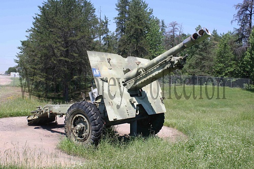

The two examples at the front gate to CFB Petawawa are in pretty shabby shape and are showing their years of neglect. Here is a photograph taken yesterday of one of the guns.

A gallon of paint and a couple hours work would do wonders for those guns Ed. Quite frankly, mine were worse than those, and is coming along nicely, although this is more than cosmetic work.
