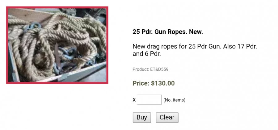

Incidentally, if anyone is needing 25pr pull ropes, I know an Aust source. Even have the leather piece still supple.
Attachment 88859
Easiest way is with the truck. Same as it is pulled off the platform. But can be done by hand.

Do you have the adress of this firm?
Gilles
How was the gun pulled onto the platform?
Were the ropes also used for that?
Attachment 88859
Old 27-02-17, 19:05
Gilles
Gilles:
http://www.timvibert.com.au/index.ph...2FCollectibles
Gilles
Gilles,
I've sent you a long laborious PM.
