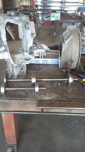

Howard/Lynn, I wouldn't go dipping the old lid yet as it might turn out to be a very time consuming anchor
Today I machined up the bearing aligning plates and rods.
Old 27-03-17, 07:12
colin jones's Avatar
Posts: 1,810
I will make a self aligning spacer for the two rods so all the gears will be pretty spot on if all goes well.

Interesting Idea Mike, I have already had a company called Castech at my place to see what they thought. It was very interesting to say the least. The inside would need to be replicated to get a full scan. The inside bottom of my block is very badly pitted and laminated quite a ways up and that would need to be removed and replaced with a scannable material. Not to mention the price to get one done with no guarantee was very scary. I have already started my machining today and then my mill decided to play electrical silly buggers but I now have my plan off attack and more than confident i'll be able to make one. Thanks for your input though.
