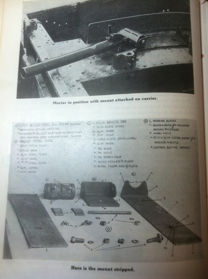

There was also a modification for the mk1 carrier where they mounted it on the engine cover instead of the firing rest that is normally in that location. I believe the source for the modification was in one of the CAMT pamphlet. It did not list the munition load, nor where to stow it.
Old 01-08-17, 14:15
Posts: 4,168
I believe this is the modification Rob is talking about.
Old 01-08-17, 14:19
Posts: 7,595
That's the one Jordan. Is that from CAMT, or one of the post war pubs?
Old 01-08-17, 14:41
Posts: 4,168
CATM Issue 59, Feb 1946
