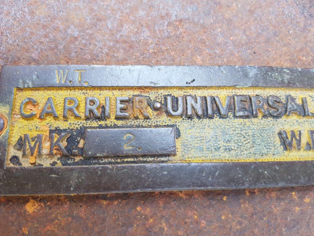

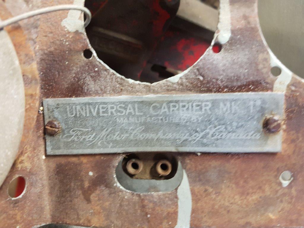

I believe your universal carrier is actually a Canadian manufactured MK-I*, converted to MK-II standard in the U.K. using the U.K. supplied conversion package. As such, there are minor differences in the wiring. For example, the MK-I* had different lighting systems, different starter, battery location and cable hook-up changed, no fuel tanks gauge or sending units with capacitors.
Please consider posting a picture of your dash panel. I suspect it is a MK-I* with push button engine starter, Canadian instrument switch MK-I*, upgraded electronic oil pressure sending unit, no fuel gauge.

A MK-I, likely a Canadian produced MK-I* for a British contract, converted using MK-II upgrade parts. Note the mantlet is British, the rear compartment firing rests do not converge. The spare bogie wheel mounting assembly is from the upgrade to Welsh Guard Stowage standard.
The hull displays MK-I* features:
1) front compartment oval shape drain opening
2) MK-I wiring conduit through divisional wall to engine
3) MK-I lower engine rails
4) MK-I upper rear protection plate wireless battery box cable access holes (x2)
5) lower hull rear plate engine openings, two rectangular holes either side of the differential
Berko MK-Istar features. Conduit battery cable holes front compartment drain and lower rear engi.jpg

Hi Michael
attached some pictures of our BrenClick image for larger version

Looks good!
Once you find the lower hull number, upper hull number, engine serial number, along with the WD number, day, month and year of manufacture and serial number on the driver front protection plate .... then compare it with the WD T 202432 number showing on the British NO.2 MK-2 bronze fender plate .... it may show that the Canadian made MK-I* was converted to NO.2 MK. 2 and a specific British fender mounted data plate was attached.
Otherwise the data plate and likely the fender is off a different vehicle.
You can see the original Ford factory two drive rivets that held the Canadian data plate remain in the protection plate on the divisional wall behind the drivers head, just below the 'FORD' plate.

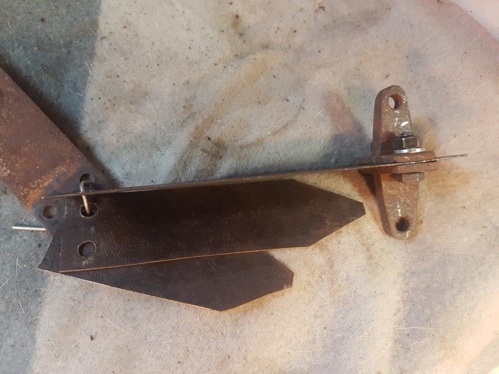

Default installed the Track Brake
Yesterday the Track Brake was installed and in addition some pictures of
some updates pictures.
4x1om Israel Berko

looking good guys ! make sure the plungers in the brake expander are in the correct way, I believe from memory they are "handed"
is mos redintegro
__5th Div___46th Div__
Lower Hull No. 10131
War Department CT54508 (SOLD)
Old 11-09-17, 09:52
Israel Berko Israel Berko is offline
Join Date: Mar 2016
Location: Israel
Posts: 64
thanks Richard,
what you mean?
4x1om Israel Berko

To clarify: Adjuster unit and Expander assembly.
The brake ADJUSTER plungers are left and right hand, i.e.: "handed".
See part numbers for the handed adjuster unit plungers:
C01UC-105217 R.H. (right hand)
C01UC-105218 L.H. (left hand)
http://mapleleafup.net/forums/showpo...6&postcount=14
Another thing to consider is the fact the EXPANDER housing is not fixed, but 'floats".
The brake expander housing is supplied with slotted or castellated brass nuts, and Thackery washers to create the necessary tension.
The floating expander housing assists with the brake adjustment

Old 08-11-17, 10:21
Join Date: Mar 2016
Location: Israel
Posts: 64
Default engine mount question,
long time since my last updates, I ordered from ebay a kit Engine Bisquits "Flathead Ford " Motor Mounts Universal 1932 34 36 37 39 40 Ford.
https://www.ebay.com/itm/Engine-Bisq...5Z25ue&vxp=mtr
Now my question is what are the Bolts (also length) and Nuts size for the engine mount?
I took the picture from Petr Brezina (Thanks)
marked in blue
4x1om Israel Berko
  #60
Old 08-11-17, 17:02
Join Date: Mar 2014
Location: Czech Republic
Posts: 549
Hi Israel, although they are not "proper" I put there metric bolts, I think M10x25 would be fine.
