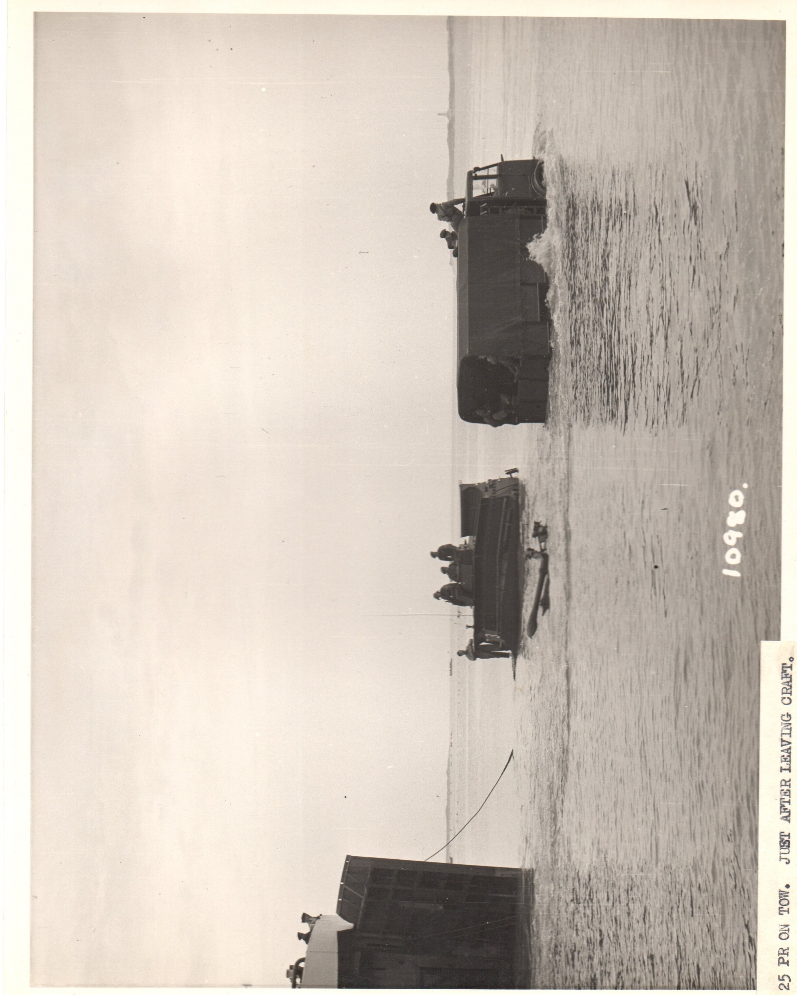

Here is a selection of photos. Most I have are close up shots of various bits of equipment waterproofed in some manner.
Waterproofing036.jpg   Waterproofing037.jpg   Waterproofing038.jpg   Waterproofing040.jpg   Waterproofing039.jpg

Here is a photo of one of the testing officers in the collection.
I am taken by how happy and warm he looks after bathing in the balmy waters of the North Sea.
Who in their right mind would choose to live in a cold climate?

I love the caption on this "17 PDR. ON TOW BEHIND A STUART TOWER"
It could be a Rolls Royce on a rope as far as any useful information goes.

Phil
I pulled a book apart. You can sort out the pages. For some reason the full page picture on some scans only came up inverted, you can rotate when/if you copy.
This is NOT the preparation for an amphibious landing, I will put that up next, it is the preparation for Long Immersion Driving eg driver training or some extreme operation. It does give a very good idea of how hard a normal vehicle is to fully waterproof. If they did this to all the vehicles at the time I think they would be ready for the Normandy invasion about Xmas this year.
Lang
