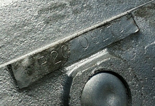

Kevin
The number you gave is just a casting number for factory use.
The number we need is stamped on the front left of the block on a raised pad.
T110 is the truck model but is also the engine series for your truck.
Lang

  #68
Old 01-11-17, 07:05
And here are examples of KEW and Plymouth numbers:
