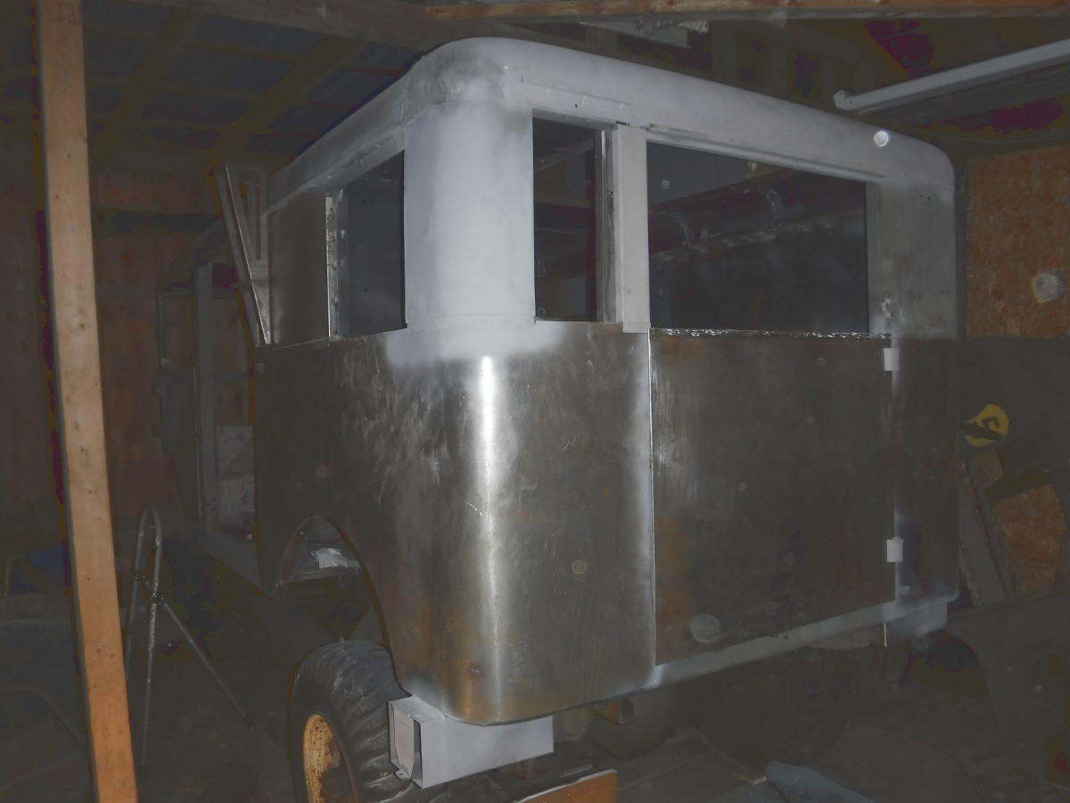

Old 22-06-21, 04:22
Got the body skin back on. I'll probably work on the roof hatches next then go back to the fenders and running boards. Or maybe the reverse...
Old 22-06-21, 05:14
Ganmain Tony's Avatar
Join Date: Jul 2009
Posts: 1,246
Default Very nice.
Strewth Bruce you do not muck around.
May I ask.. is the skin new steel? If so what gauge thickness is it?
If you were able to use the original, was there much work in repairing it?
It is going to be a very nice example.

All the body skin except the side body door and two upper corners that wrap around the back/rear sides are new 18 gauge which matches the original 'skin' (I took a lot of notes and photos!!). I was also able to save a portion of the roof that was reinforced for the aerial bases but the section rear of that and up to the sliding roof hatch needed replacing. The gem that saved me (because otherwise I don't know what I would have done) is finding a rear top body section with all those curves. After breaking about a million welds and spot welds it fit on great. Oh, and the floor is original which not only saves me a ton of work but has a checker plate pattern I doubt I could find anymore.
Old 23-06-21, 12:23
Join Date: Jul 2009
Posts: 1,246
Default Thanks Bruce
Thanks for taking the time to explain that Bruce.
Enjoying this thread and will continue to visit with interest and to pester you further with questions.
