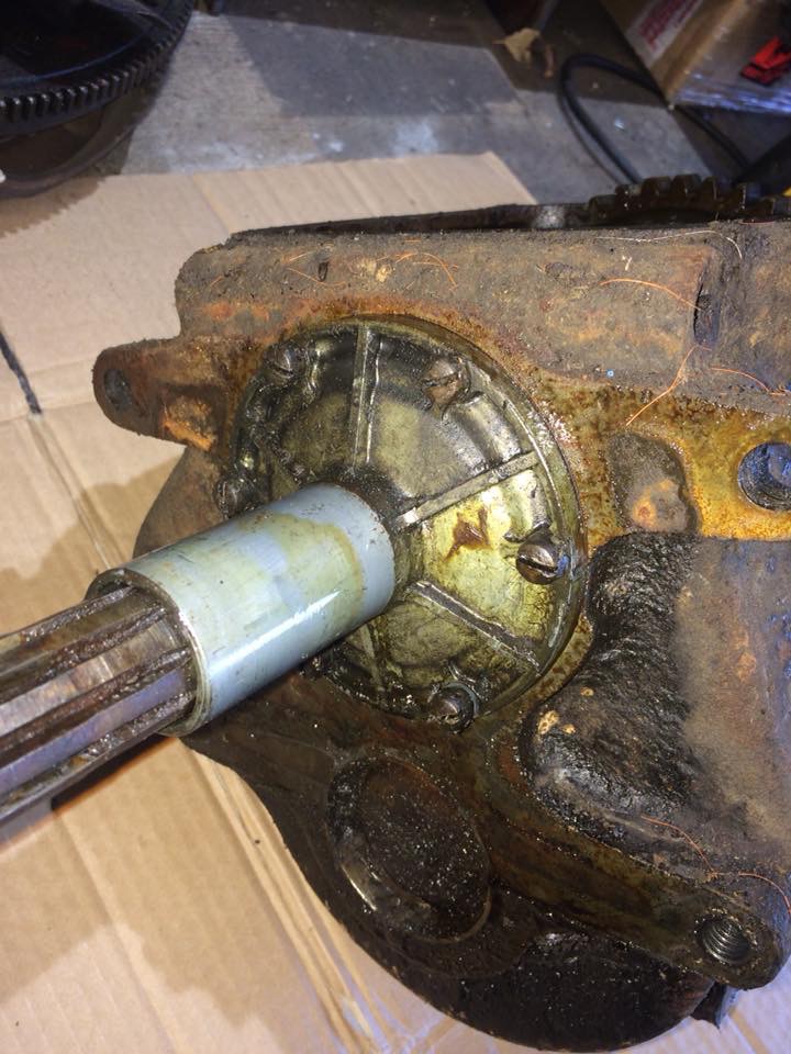

In the meantime while I’m waiting for this parts I decided to start the pulling apart of the transmission. Everything is coming apart nicely and I’ve got some bits soaking in parts cleaner to remove the 75 year old grease/oil. I’m really glad Bob Carrier posted that link to those hard to remove shaft seals and that I picked up a couple of them. Removing the original destroyed it.
A coupe of the gears have some minor rusting but I feel these should still clean up alright and be good to go. I’m also planning on replacing the bearings. Would it be best to use fully sealed ones?

Possible problems with sealed bearings:
Fully sealed, you will be relying on the grease within the bearing only, no transmission oil will get in, so new oil in the transmission only helps the gears, same old lubricant in the bearings.
Sealed one side (outer face), solves the issue above but no lubricant reaches the original style seals to help them slide on the shaft so they are likely to have a shorter life.
My choice would be new seals, separate from the bearing, running on original shaft (as long as it shows no grooving). I forget whether the gear clusters are one piece or pressed onto the shafts. If they are pressed assemblies, adding speedisleeves to repair scored shafts could make them difficult to take apart if you ever need to separate the cluster. But on the mileage we do on restored trucks what are the chances of that?

I, too, have pondered whether to leave the seals or not. Really, for all the miles we will ever put on, the grease within the bearings will be more than enough. I have also removed just the seal on the oil side. I normally pack a little grease into the output seal, so my take on it is if there is not enough lubricant over time that the output seal suffers, then the seal really isn't necessary.
Where these sealed bearings really shine is on the input shafts of the transmissions, especially the Ford CMPs and the Willys Jeeps, neither of which has a particularly effective seal.

While waiting for the armature to arrive I’ve decided to pull apart the transmission. Following the steps in the maintenance manual everything came apart as it should. All looks really good. Tomorrow will be spent cleaning up the housing and degreasing the gears.
