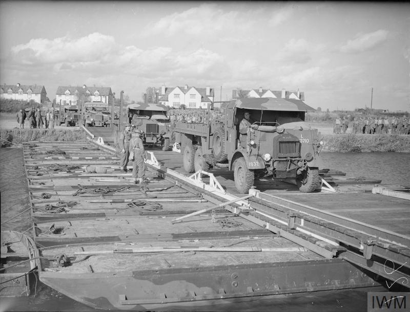

While looking for info on British and Canadian Pontoons, I noticed IWM has quite a selection of pictures.....I don't know if these are recently added to the site, or if I just missed them before, but I am attaching a few.
source: https://www.iwm.org.uk/collections/search
I am specifically looking for measurements and/or scale plans of MkV and MkVI pontoons.....or any info on possible survivors. If anyone knows of any drawings, please let me know. Post-war nato pontoons seem to be a dime a dozen here, but I can't remember seeing any WW2 Commonwealth pontoons.
EA 22916.jpg   large_H_004673_1.jpg   large_B_006994_1.jpg   large_B_006998_1.jpg   H 4689.jpg

  #188
Old 19-03-20, 23:39
The first pictures seems to show a pontoon in use as a sled!
I am presuming these pontoons were plywood, which could be a reason you hardly see any surviving examples (?)
BU 2127.jpg   large_B_006992_1.jpg   large_B_006993_1.jpg   large_B_006996_1.jpg   large_B_012136_1.jpg

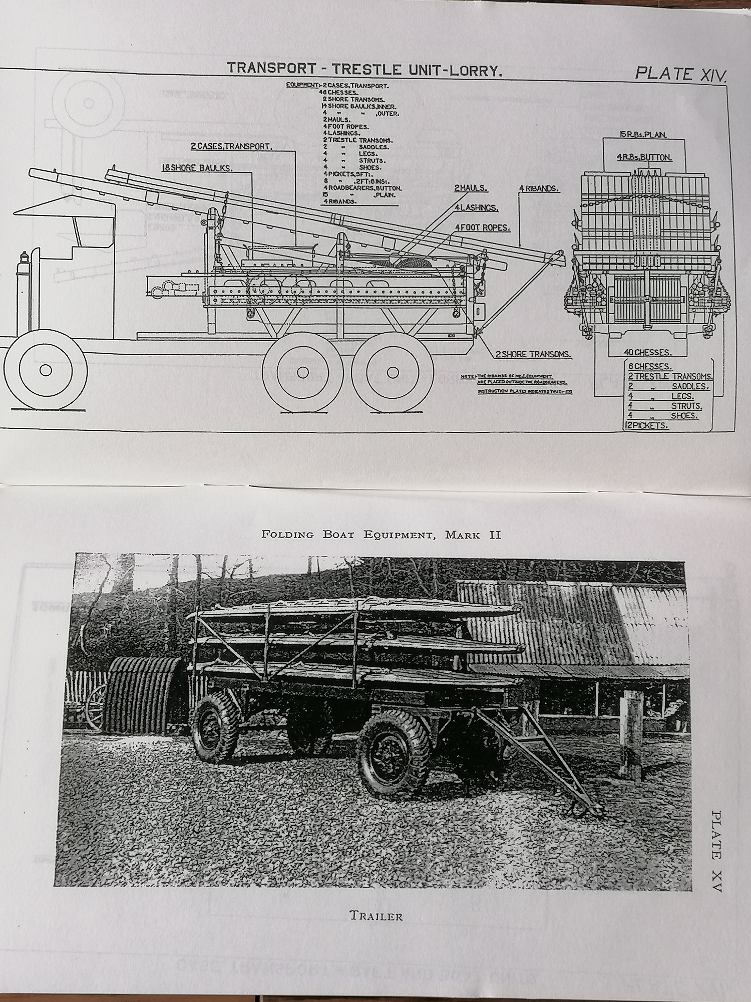

I am trying to source which publication the attached drawings are from that David posted earlier in this thread, as I am hoping to get a larger scan of the diagrams?
Does anyone know the source of these diagrams?
I am still looking for some higher resolution scans of the drawings attached. Does anyone know where these came from?
And does anyone know if there ever was a manual/publication on the Folding boat and pontoon equipment as used on the Canadian Diamond T 975's.....apart from the diagram from the design records?

Old 06-02-24, 01:35
Ed, Thanks for taking the time to look into this.
I have purchased copies the first two pamphlets you mentioned; Pamphlet no. 2, dated 1939 and Pamphlet no. 13, dated 1945.
The former shows some diagrams of very early trucks FBE trucks, which are not the ones I am after, but nonetheless interesting to add to this thread.
The latter does show the trucks with the 4 pillars, but only as a picture, not the diagrams that David posted here years ago.
