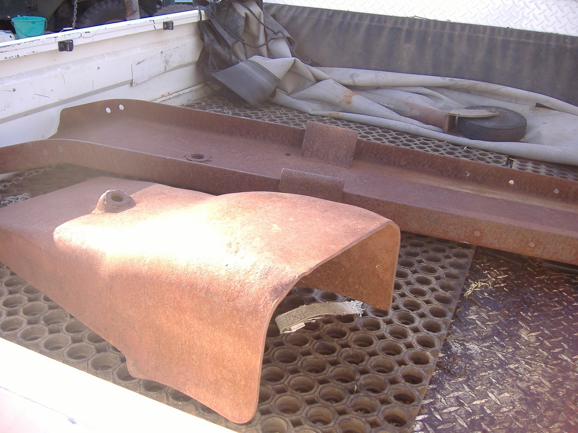

Default Canadian spare tyre carrier ?
I bought this spare tyre carrier yesterday. I am hoping it is the correct Canadian carrier for a 20 inch tyre on my Indian C60L.
This is all I have. I searched for a picture of what goes on the opposite end to the little ramp to stop the tyre rolling off.
Would someone have a picture of the opposite side?
One picture I saw shows brackets that lift the carrier up above the chassis, similar to Australian brackets but with pressed in strengthening dimples.Canadian spare tyre carrier.JPG
Ken
One picture I saw shows brackets that lift the carrier up above the chassis, similar to Australian brackets but with pressed in strengthening dimples.Attachment 110048
Attachment 110049
Ken
Pretty sure there were two or three different types . 1 sided clam and double sided clam type. The one I have has a back and wheel dimple

Join Date: Apr 2008
Location: Qld Australia
Posts: 238
Thanks for the tyre carrier picture Andrew. That carrier looks shorter than mine, I like the design of the fixed end, that has some character. I will use that design for mine when I make it.
Cheers Ken
