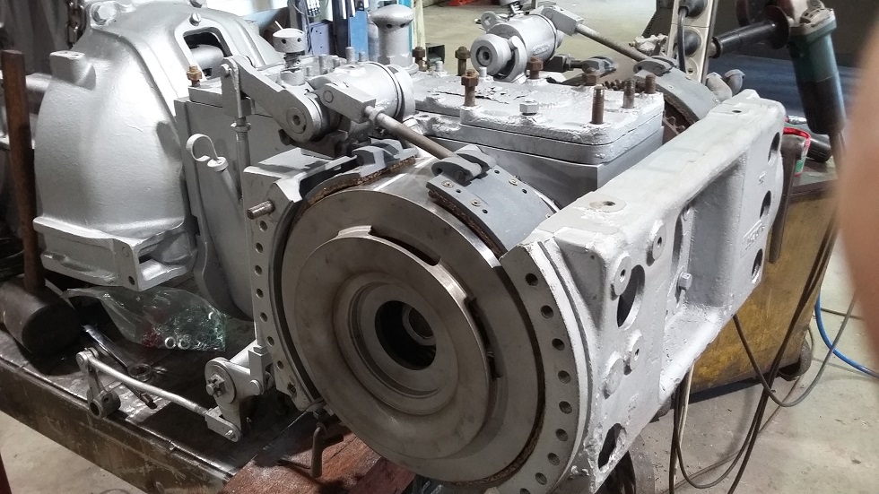

I had to complete the rest of the turning clutch drum. The chap that cut it for me left excess so I can do my welding and then machine it down to size.
20180823_140848.jpg   20180823_140917.jpg   20180824_094126.jpg   20180824_110840.jpg   20180825_095928.jpg
  #913
Old 25-08-18, 11:13
colin jones's Avatar
Posts: 1,810
He did a great job as the clutches fit in really nice. I have changed the design a bit to suit myself but it will still be OK.
20180825_112245.jpg   20180825_114819.jpg   20180825_143337.jpg   20180825_151420.jpg

I have assembled the steering clutches but not the fine adjustment yet. I guess that will be done after installation as I don't have details of that part so a bit of trial and error to come. I have just temporarily put the newly made clutch cover on for a bit of a test fit and it is excellent.
20180828_141230.jpg   20180828_141554.jpg   20180828_141607.jpg   20180828_141620.jpg

I think your redesign of the clutch drum is very sensible. It will be much stronger than the original which was obviously too fragile judging by the brazed repair where the centre had been ripped out of it. That reduced the cooling venilation area to less than yours and it evidently worked so I think you probably have a better cooling / strength compromise than the original, plus it was easier to make.
I can't wait for the next installment...

Hi David, I am more than confident the change I have made is considerably stronger than the original and the easiest way I could reproduce it. They did a great job of the old repair as it was probably done during its military days and still very strong.
George, that part was sorted out quite well back on page 27 and it all made very good sense why it was designed the way is was and thanks for your input.
Colin.
