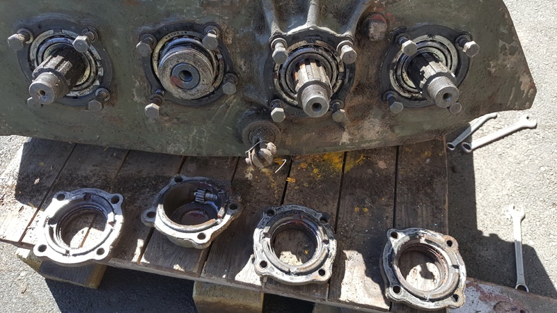

Hi all,
Here are a few photos of what I’ve been working on over the last week.
Thanks to Willy for confirming the black rubber type spacers are the correct one for the headlights. These spacers do have a slot in the middle for the top rim of the headlight sleeve to fit into. When fitted on the sleeves, they need a bit of downward pressure into the hole in the hull so that the brass bush in the handle hole can be pushed through to lock the sleeve in place.
I have the fuel pump and fuel lines fitted in the front of the hull now. The line in the foreground of the photo would normally be at the very front of the hull but it seemed to fit nicely as I have it so I left it at that. I used a bit of thread sealant on all the connections so hopefully all will be well with them.
The reassembly of the intermediate and rear axles is progressing. I’m now at the stage of making up the fixed brake lines for the axles. I have no templates so I am working off photos and the plans from the parts manual to do these.
Does anyone have any axle brake T connections spare that they would be prepared to part with? I have fitted four of the six required but the other two I have are both used and have damaged threads. Originals seem to be very hard to find. Can anyone assist please?
What is the easiest way to install the intermediate and rear axle? The manual says that the back of the vehicle needs to be lifted to a height to get the two axles under it. I guess then it is just a matter of aligning the ends of the leaf springs with the two openings on each of the axles.
My plan was to get the boys in the engineering workshop next door to bring in their truck and hiab crane. We’ll lift the front of the hull and then fit the front wheels to the front axle. Then we can lift the rear of the hull enough so that I can roll the intermediate and rear axles under the hull.
Once the rear leaf spring ends are in the slots on the axles, will the weight of the hull settle enough on the axles to stop them moving around, or will I need to get the torque rods locked in straight away?
There is not a lot of information in the manuals about the torque rods in the manuals, and how they are fitted and adjusted. Has anyone got any first-hand experience with these? Are the top ones adjusted simply to keep the alignment of the axles correct?
I’ve noticed that the handbrake cable is a real bugger to fit into place on the hull side. The cable comes down tube in the side of the hull and has to make an almost 90 degree turn to go into the mount on the hull. The cable is quite stiff so getting it to slide down the tube and then sideways into the mount is not easy. Does anyone have any bright ideas on this? My one is just into the mount but it really needs to go in about another ¾ inch.
That is all.
Merry Xmas.

I have the M8 on its axles now. Once I completed the final touches on the rear and intermediate axles, I positioned them behind the hull and got one of the guys in the engineering workshop to bring the crane truck through. We opted to lift the rear of the hull first and get the rear and intermediate axles in place first, before lifting the front of the hull off its blocks and putting the front wheels on. It all went pretty smoothly but it was still about 2 hours work by the time I dealt with positioning the axles and fitting the torque rods to hold them in place. Thanks to Willy and Reg, I found that I could use two of the tie rod ends for the adjustable torque rods that were already on the rear axle. There was enough movement everywhere to allow me to fit the adjustable rods to those ends and secure the other end on its pin.
I feel like I’ve reached another milestone with the restoration in getting it to this stage, and it is a good feeling to see it on wheels. I still have some work to do though in setting up the torque rods. One of the fixed torque rods I had (not an original) seems to have a slightly bigger diameter pin on the ends and it won't seat properly in the hole on the trunnion or in the axle, so I think I will need to find an original. I also ran out of time to tidy up the threads on the torque rod mounting pins before the truck arrived, so I still need to find a 1 1/4-12 die nut and tidy the threads up.
Out of interest, what type and capacity of jack do the M8 and M20 owners use to lift an axle and remove a wheel?
I need to get some more of the 7/16” axle stud adaptors as shown in the photo. These align the internal axle in the hub and are described as adaptors in the manual. I would have called them collets, but can anyone point me to a supplier for these? I see they are on EBay as part of modern commercial wheel stud kits but I haven’t found them sold seperately yet.
Before putting the M8 on its axles, I took the opportunity to put some of the paint stencils on. It was a good height to work from without the wheels on. I used water based flat white paint and applied it with a roller. The markings came out really well and I’m very pleased with them. The only issue I had was trying to keep the star decal on the front straight as it went over the two raised strips of steel that go across the front of the hull. I found the best way to deal with that was to cut the decal in a couple of places to get it to go evenly over those steel strips, and then cover the cut with some bits of masking tape. I got the odd bit of paint bleeding through in those areas, but that scraped off nice and easy. These were good paint stencils and I had good support from Tony, the supplier.
That is all for this week.

  #324
Old 22-02-19, 15:03
Big D Big D is offline
Darryl
Join Date: May 2008
Posts: 661
Default M8 restoration
Hi all,
I’ve been busy with work and life for the last few weeks and I haven’t posted for a while, so here are a few updates on what I’ve been up to on the M8.
I have stripped and reconditioned the transfer case. Overall it was not in bad shape and I don’t think it has been that long since it has been apart. All the flanges came off easily which I’ve found is a good indicator. The gears had some light corrosion on them from the transfer case sitting around with little oil in it. As per the photos, some of the teeth on a couple of the gears had some pitting resulting from the corrosion from that sitting around. I have cleaned that up and the pitting shouldn’t create any issues.
The bearings looked good and just required cleaning. I cleaned up all the gears and flushed and cleaned the internals. I found some oil seals ‘off the shelf’ from a local supplier which were the correct size for the bearing caps. The same seal is required for the handbrake drum bracket but the fit on this was a whole lot tighter, and it needed some persuasion to get it in there.
I did notice a very fine hairline crack in the front axle declutch housing. Looking back at my pre-disassembly photos, I see the crack was there and just visible under the old paint, so it might have been there for a long time with the paint and dirt holding it together. I have covered it in some epoxy adhesive which should seal it. I made up new gaskets, and cleaned all the shims from each bearing cap and fitted them as they were. All clearances seemed pretty good. I cleaned up the rest of the transfer case and a coat of paint freshened it up nicely. Let’s hope it doesn’t leak!
I fabricated some retainers for the rubber mounting cushions out of a bit of channel with some angled steel which will form the mounting strips on the sides. I will finish the welding and tidy them up over the weekend and then hoist the transfer case up into place on the hull.
20190204_094820.jpg   20190204_113511.jpg   20190204_115238.jpg   20190205_133155.jpg   20190206_111040.jpg
