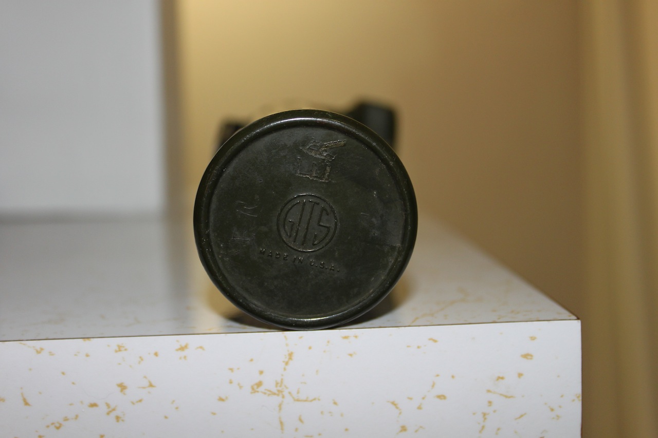

This large gem was a surprise addition to the project a week ago when I got a call from Reg Hodgson, in Edmonton, that he had found a pair locally.
Only two coats of paint on the entire case. The first is the factory original flat or semi flat OD Green and a shadow of some of the stencil markings are still visible. Photo one. Hopefully more markings will be revealed when I get to restoring this case. This has all been done over in a gloss battleship grey overall with a funny green band on the right side of the lid. Photo two.
Several ‘cracks’ are visible in the wood, as a result of this case being stored in a damp environment at some point. Also, the putty filler used to cover the perimeter screw holes has fallen out of several of them. One of the really interesting bits about this case, however, is on the lid. The handle assembly is original. All factory rivets are still there as originally installed. But take a close look at the left side handle bracket. It is incorrect. It is a right hand bracket installed there. The correct bracket should be a mirror image of the right side bracket. Interesting mystery as to why that might have happened. Whoever installed it realized the bracket had to be flipped around for the handle to still function correctly.
The third photo shows the bottom of the case where a lot of putty plugs have fallen out and a large ‘crack’ runs full length across the bottom of the case. The wood is slightly humped at that point and I was rather concerned about that until I had a closer look at the left side of the case in Photo four. This photo shows the excellent finger jointing work done on this case. It also revealed another feature I had not expected, but upon discovering it, it made a lot of sense. What I though were cracks, are in fact the tongue and groove joints used to connect various strips of pine together to get the board sizes they needed to craft these cases. Animal glues would have been used in these joints and the damp conditions this box experienced were enough to dissolve the glue and allow the boards to separate a bit from one another and from the bottom edge of the case, resulting in the slight hump.
The last photo is of the interior of the case. The KimPak lining on the right side has some serious damage. My suspicion is the damp caused the padding to swell and it was subsequently pushed down a bit. Again, likely caused by dissolving glue. There would have been a newsprint paper label on the inside lid listing the case contents, this has fallen off and been lost. In the left side compartment, the wrap of KimPak around the sides has fallen off but the pad at the bottom is still in place.
My current thought for both cases so far, is to restore the exteriors and leave the interiors as original as possible, thereby saving a bit of their history.
As for the items inside the case? Reg tells me both cases he found had the same contents. More on those later.

Posts: 3,721
Default Torches, Hand, 2-Cell, No. C1 WB/CAN 4737
Here is another example of how the detail in the illustrations from the 52-Set Parts List provide valuable information to help correctly identify parts.
If one starts researching this torch with the Working Instructions Manual, the photograph on Page 124 shows the torch to be an angle head item, with a small diameter clear lens. The description on Page 160 simply is “Torches Hand 2 Cell” and notes that either it, or, “Torches Hand 2 Cell, Eveready No. 9250” can be issued with the set, but not both.
I tried searching for more information on the Eveready torch but have yet to find any images of one. I am assuming it might be a similar design to the other referenced item.
Then I took a closer look at the illustration and description of the torch in the Master Parts List. The text provided another clue; the torch had a plastic body, not painted brass. A closer look at the illustration finally revealed a possible model number cast inside the circle on the side of the torch by the neck: TL-122-B. A web search for that model number produced a flood of results. Too many really. It was quickly evident a number of manufacturers were involved in the production of these torches during the war.
I did notice, however, that a number of manufacturers placed their name in the circle on the left side of the torch and the model number was on the right side only. So I started by ruling them out. Then I noticed whenever a torch showed up with the model number cast on both sides of the neck, the manufacturers name was cast into the bottom cap of the torch. That helped narrow things down even more.
Another look at the illustration showed a very distinct shield shaped switch plate, with the slide switch below the button switch. Over four months, only two shield shaped switch plates ever showed up on line. Most were rectangular of some style. Of the two shield styles, one was a perfect match. Any torches with it also had the model number on both sides of the head. Turns out the maker of this torch is GITS (GITS BROTHERS MANUFACTURING COMPANY), and their logo is cast into the bottom cap.
Again, I could not have sorted this all out without the details in the Parts List illustrations.
Torches, Hand, 2-Cell, No. C1  WB:CAN 4737.jpg   Torches, Hand, 2-Cell, No. C1  WB:CAN 4737 A.JPG   Torches, Hand, 2-Cell, No. C1  WB:CAN 4737 B.JPG   Torches, Hand, 2-Cell, No. C1  WB:CAN 4737 C.JPG
