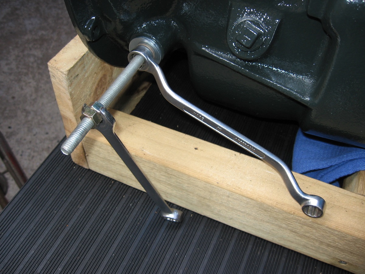

Default Ford CMP- Installing clutch cross shaft bushings
Good Day,
Well, I finished my bushing guide tool on the lathe yesterday. My buddy is no longer wearing an Elizabethan collar so I could spend more time in the shed.
I was going to make it out of brass but then thought it was a bit of overkill so used a piece of 25mm nylon rod I had laying around.
Simple design: the pilot end has a section the same diameter as the inside of the bushing and a section the same diameter as the outside of the bushing. This ensures the bushing is pulled straight at all times. Two collars for the pulling end: one with the same diameter as the outside diameter of the bushing to install the first bushing, and one with same diameter as the inside diameter of the bushing to install the second bushing. Six mudguard washers and 4 nuts for the 3/8 UNC threaded rod finishes it off.
It worked a treat! A bit of 3 in One oil for lube and they pulled in nicely.
Not a lot of force on the spanners was required but I am convinced the solid bronze bushings would not just tap in without damage so I am glad I went to the extra trouble. No more shake, rattle, and roll on the cross shaft!
Hope this is of some interest.

Default Ford F-15A speedometer gears
Good Day,
While working on sorting out my speedo cable I had an idea that perhaps a Ford commercial truck speedometer driven gear might work in the single speed transfer case despite the Parts Manual identifying it as unique to CMP's.
I had recently sold an F-15 transmission and took photos of the speedometer gear used at the back of the transmission for the buyer. See first photo. If I could use a similar commercial gear then the drive cable end at the transfer case would be a simple formed square in the cable instead of a keyhole fitting which would make shortening the cable simpler.
The F-15 uses a 20 tooth driven gear but I could find no info on the number of teeth on a F-15A. So I removed the gear sleeve and driven gear to see what it looked like. See second photo. Surprisingly it is only a 15 tooth gear so it sure is unique to CMP's! Most Ford commercial truck speedometer gears are 18, 19, or 20 tooth. The F-15A gear is very different in other aspects also.
I then wondered why the big discrepancy in the number of teeth as an F-15 has a 6.66:1 diff and the F-15A a 6.50:1 diff. Very similar ratios and both use 16" wheels. Probably caused by the difference of number of teeth on the speedometer drive gear in the two vehicle types but I didn't have the number for a F-15.
I found a good device to determine number of teeth required for a speedometer gear on the Summit Racing website.
Inputting 4 teeth for drive gear- known from Parts Manual.
6.27 for diff ratio- (27/28 x 6.50 to allow for 27 teeth on driven gears in transfer case and 28 teeth on the idler where the speedometer gears are).
34"- for the tyre diameter as measured.
And Bingo 14.86 teeth!
