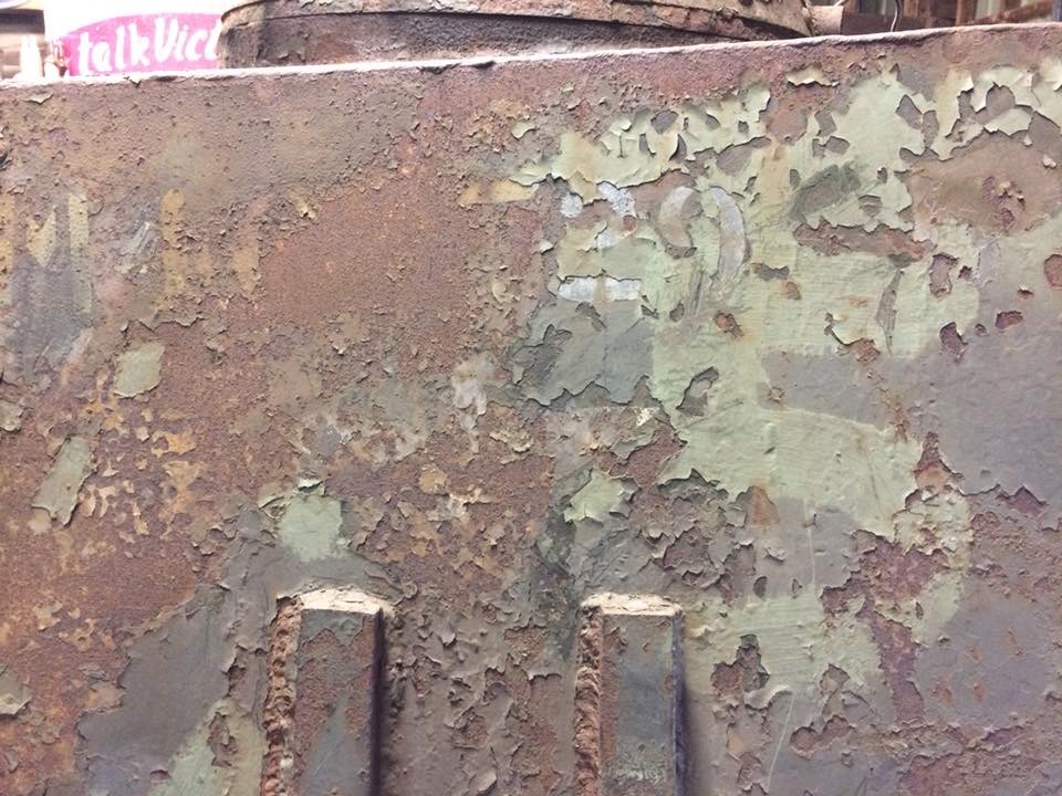

More original markings found. On the passenger door is the W/T. The exciting find was on the rear lower plate. It’s original CMD #. I think it’s CMD 26407. Lastly I found on the right rear fender what I believe to be a postwar Dutch marking. The Netherlands flag in what I think was a black circle.
It’s nice finding these numbers as hopefully as others have said this vehicle can be traced.
Alex, I’ve checked the white plate underneath and it doesn’t look to have had any thing. The lower front plate might have something but it will have to wait since the nose is pretty close to the shop door. Thanks for those pictures. I have not seen those ones before.
Jordan, you might even be able to find an orange lion marking under the red-white-blue dutch flag. The black circle with orange lion was the marking used just after the war (and during the war by the Irene Brigade), later in life Dutch army vehicles received a licence plate and red-white-blue flag in stead of the older style markings.

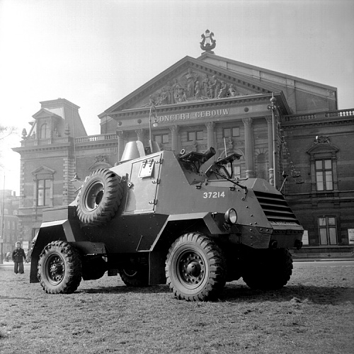

To add to that, here's an example of an Otter with the early post-war markings, consisting of an orange lion on a black circle on the center of the nose, plus a five digit census number in white on the side of the bonnet:

An Otter of the Military Police in front of the "Concertgebouw" (Concert hall) during a military parade, Museumplein, Amsterdam, 27 March 1952 (Foto Ben van Meerendonk / AHF, collectie IISG, Amsterdam)

I’ll have to try the black light. I’m finding that the upper layers can easily be chipped off using a small scraper tool from the wartime white paint. It must have had enough of a smooth surface to reduce the adhesion. After the holidays I’m gong to contact Library and Archives to see about getting copies of the War Diaries for 3rd Infantry Brigade Company. Sadly they are not online.

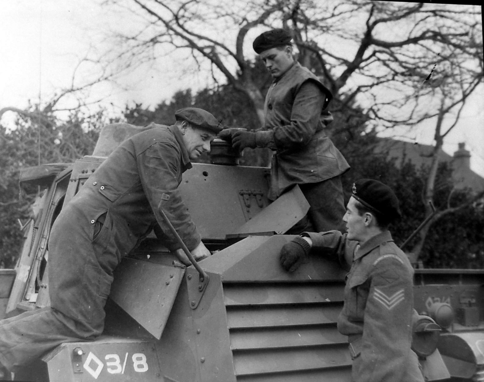

The original factory applied WD#. The first picture is on the left side of the hull. Picture 2 is on the right side. At some point in its life it had a spare tire mount added. This went right over the factory applied WD#.
Picture 3 is an odd marking I found either on or under the factory paint layer. I also found these numbers on the turret opening guard. I’m wondering if they were left over markings during the manufacturing process?

I think it is very likely that at least some are markings left over from the manufacturing process. There will have been a Shop number for the vehicle as a whole but there will also have been batch numbers, individual part and assembly numbers and quality control marks. If you can find good factory shots of vehicles under construction you may get some idea of what was typical. I don't know about Otters but Rams, Grizzlies and Sextons had their Shop number stamped into the hull itself and there was a correlation to the original Army / WD number.

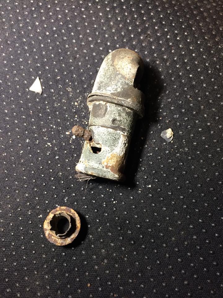

Interior lamp assembly for the Otter. It’s pretty much the same as found on the Universal Carrier dash. However it only uses one wire and the socket is grounded versus the double wire on the Universal Carrier.
Sadly something smacked the lamp pretty hard at some point and crushed in the dome. The mounting bracket was also bent and broken because of that as well. I clamped the two parts and backed them with some brass washers then used my Mig welder. Came out very well. I did go back and re weld the one joint as I wasn’t happy with it the first time. Now to see about straightening out the dome. It’s thin brass so I’m not too hopeful it will.

I’m just about finished with the interior lamp. Thankfully after annealing the brass hood it came back to its proper shape quite easily. I also managed to get the threaded end seated back into the lamp body.

Today I discovered the remains of the Allied star on the side of the hull.

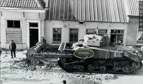

When studying the Sherman and Churchill tanks at Westkapelle, I noted that the census numbers seems to have been painted over - see below. The tanks seem to be have abandoned in situ, struck off strenght, markings painted over, and then were transferred administratively to the Dutch war assets organization which sold them for scrap.
Sherman V Crab, T-148656,.... Circa 1946, still in the same spot and still complete but the WD census number seems to have been painted out. Maybe because it has been struck off census?
