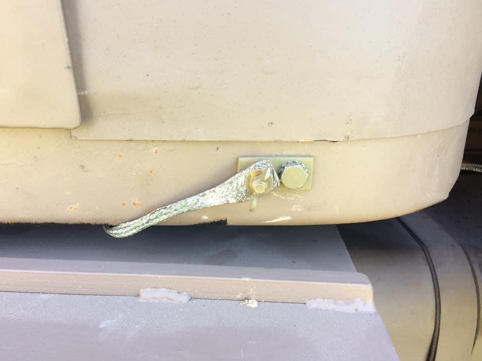

I’ve finished the restoration of the Chorehorse and it’s now mounted on the removable tray. There was also a “quick release” ground strap hookup point on the cab frame. I used an NOS 36” long Chorehorse ground strap. Once hooked up to the charging panel the Chorehorse fires right up.

Nice find for the chorehorse ground strap by the way. Hard to tell if it is early or late pattern under the wing nut. Early ones simply had the end flattened and solder dipped, with a hole drilled into it. I suspect that caused a few wing nuts to get lost, having to completely remove them, which negated the ‘quick release’ concept somewhat as well. Later straps had an an angled slot cut into them rather than just a hole, and I think some makers may have added a small square of folded over sheet metal slotted at an angle as well. These allowed a simple loosening of the wing nut rather than complete removal.

As for the ground strap it must be one of early ones with the solid flattened end and hole drilled through. No slot to be found.
