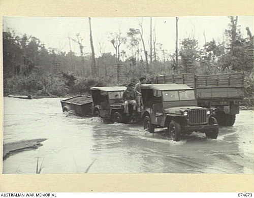

Posts: 14,943
Originally Posted by Mike K View Post
Certainly is!
Description
LAE-NADZAB, NEW GUINEA. 1944-07-19. PERSONNEL OF THE MILITARY HISTORY SECTION PREPARING TO USE THEIR HEAVY TRUCK TO HAUL A JEEP AND TRAILER OUT OF A BADLY FLOODED SECTION OF THE LAE-NADZAB ROAD. SEEN IS:- DRIVER E. YOUNG (1).
