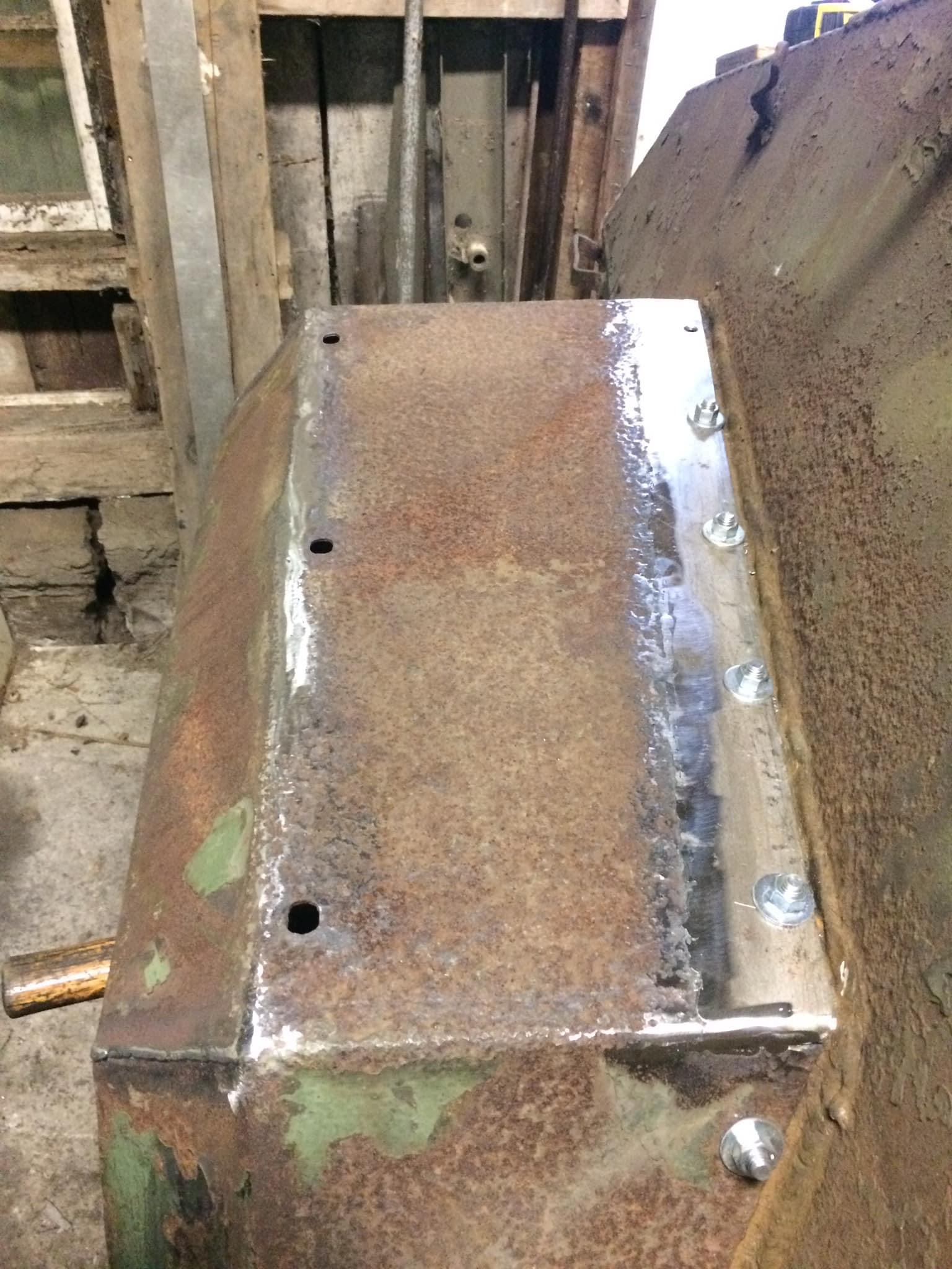

Last fender getting the rebuild treatment. I had to cut out the rear edge as it was badly rusted out in spots. I also had to weld up the bend along the front edge. The metal had gotten very thin and then was cracking along the bend when the flare was bent back to shape. Lots of weld, grind and repeat.
