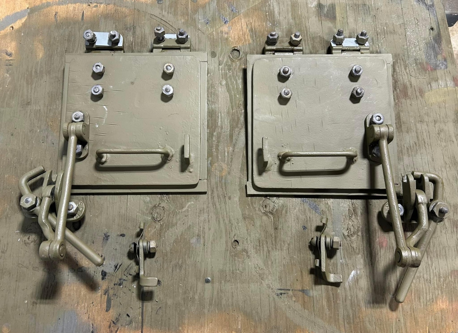

Last of the front hatches finished up. The only thing that needed replacement were a few badly corroded nuts.
Next was the removal of the door vision hatches. In some of my pictures you may have noticed some text. I am really enjoying the text feature my iPhone and iPad have. It is super simple to add some captions right after taking a picture. Such as noting which shim went where or the location of specific bolts. Yes I’m doing my best to put the same bolt back in the same spot.

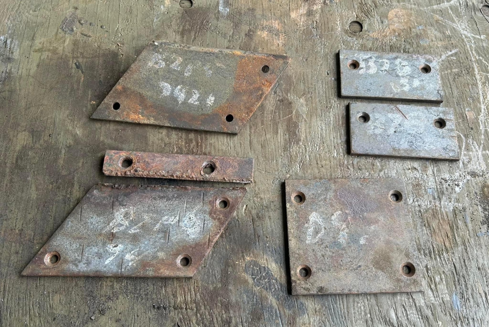

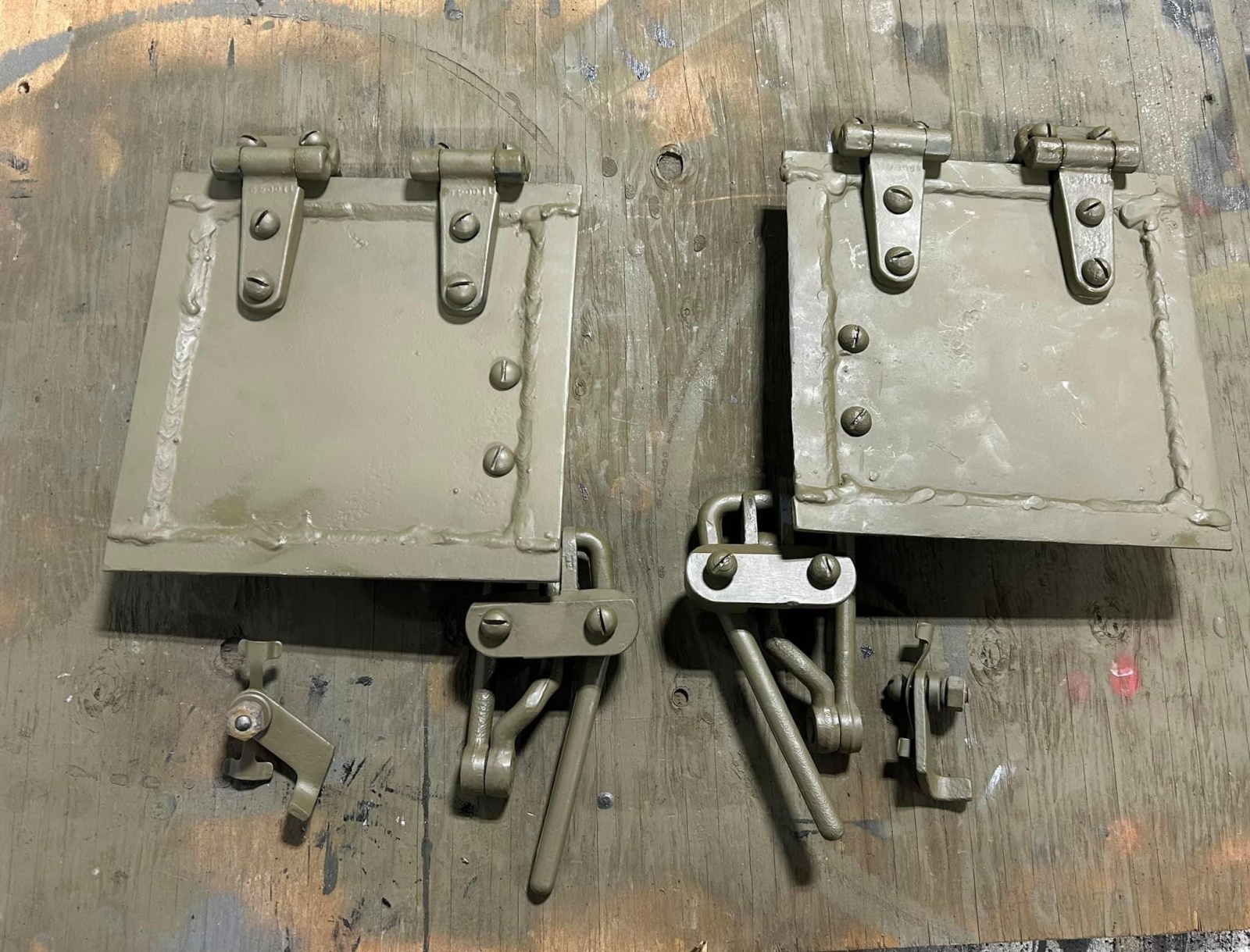

Door vision hatches all taken apart, sandblasted and repainted and put aside.
Next up was the cover plates in the armoured body. These plates gave access to points on the frame for the rear spring mounts and steering arm. It was neat to see more hand applied assembly markings from Hamilton Bridge.

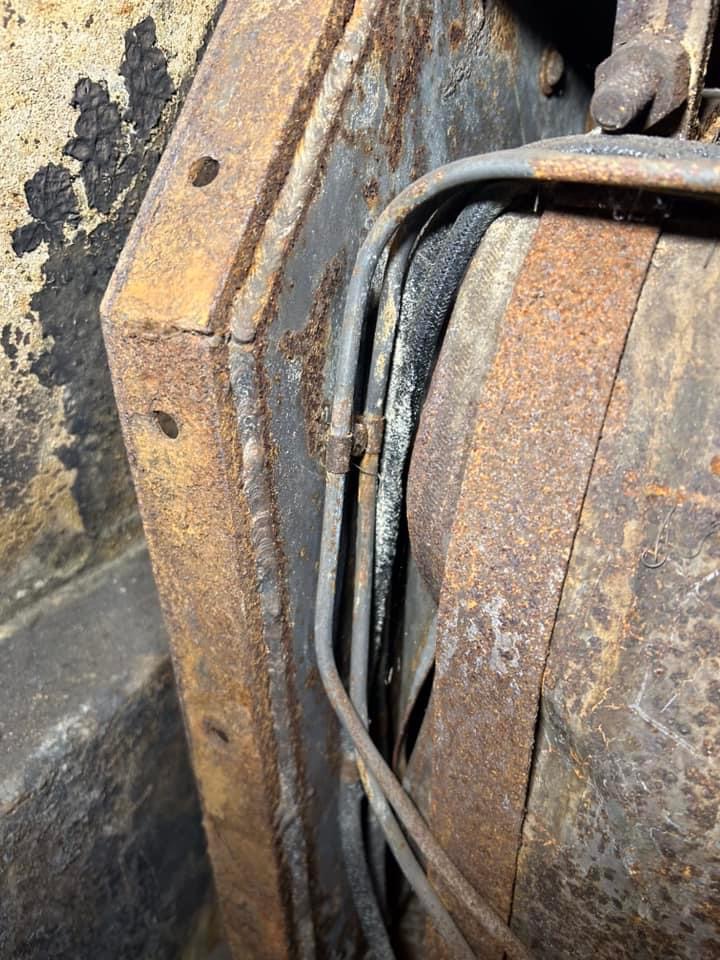

Well tonight I managed to finally remove the fuel tank. But first I took a bunch of pictures to capture how everything with the fuel lines and electrical went together.

Detail pictures of the fuel tank. It’s pretty solid but did rupture during the fire. My thoughts are to repair this tank vs making a new one.

That is an interesting arrangement, Jordan. Two tanks sharing a common end wall?
Did the two halves feed to a common selector valve, and I assume that would also mean a selector switch as well at the dash to be able to read both tanks as required.
  #383
Old 15-08-24, 19:22
Posts: 4,191
Hi David.
Yes it’s one tank construction but divided in the middle. There is also a baffle on each side. Two drains and two fill ports. Two fuel senders as well. Two fuel lines run in the frame rail up to a standard CMP type 3 way fuel selector valve. On the dash there is one fuel gauge with a tank selector switch.

Based solely on your photos, Jordan, that tank looks a lot shorter than a pair of 15-cwt tanks would be, sitting end to end, but it looks a lot chubbier. It must have been fun to fill in the field.
  #387
Old 16-08-24, 05:24
Posts: 4,191
I took another quick look at the tank tonight. Both ends are ruptured so I’ll have to remove the end pieces and figure out how to undo the crimping. I suspect both baffles have popped looking at how the parts of the tank are more “round” than other parts. Removing the end caps will also be good for getting the inside completely clean.
As for lingering fumes. The fire would have burned off anything that was still there.
The double tank is 41” long, 18” high and 12” wide. It works out to about 30 imperial gallons. The filling spot definitely isn’t handy.
  #388
Old 17-08-24, 20:51
Posts: 3,721
I have been thinking about the fuel tank situation with your Otter, Jordan, and wanted to offer some observations and ideas on the topic.
Essentially, you have one large fuel tank, sealed and divided at the centre-line, mirror imaged outwards from that point, and it needs a bit of TLC.
If it were my tank, Jordan, the first thing I would do is study the hell out of it to learn as much as possible before attempting any disassembly. It should be able to tell you a lot about itself. You already know the tank was in a fire with enough volatiles still inside it to cause it to explode. If both tanks were expanding under pressure at the same rate during the fire, then the internal pressures on either side of the centre dividing plate would be equal and that plate would stay in place and should be OK. As pressures built within the tank, the external sheet steel would start to stretch and expand and the end plates begin to stretch and bulge out until one, or both ends ruptured to release the internal pressure. Did both ends eventually rupture, or just one? Also look at the amount of stretching evident on the sheet metal of both sides of the tank. Do they both look equally bulged out, or is one side more pronounced than the other? The side with more stretched sheet metal was likely the tank with the most volatiles in it during the fire. As an aside on this point, and bearing in mind potential years of fiddling may have happened, but did the fuel tank selector valve still point to the tank showing the greatest expansion/rupture? That would show the valve was still it its point of last use when you obtained the Otter, still set as left.
Then take a close look at the centreline of the tank, where the dividing wall is fitted. What you would like to see here, is that the dividing wall survived the stretch and rupture process of the tank in the fire. If you have a large roofing square handy, it will help in the analysis. If the dividing wall held its ground, visually, you should see something of a wasp-waist effect on the sides of the tank at the centreline. The centreline will reflect the factory shape and dimensions of the tank with things getting bigger as you move away, either side. All four sides at the centreline should also be very close to square and flat, versus other cross-sections moving towards the ends of the tank.
At this point, you might want to jury rig a small inspection lamp from an automotive lamp socket and bulb with enough leads you can lower it into one side of the tank through the filler and cover the filler with a rag in a dark room. What you don’t want to see when looking into the other filler tube is any sign of the light being visible from the other tank. You may want to use a flex mirror to have a better look. If all looks dark, the dividing wall is likely in good shape. If you do see some light, see if you can determine if it matches up to the most bulged side of the tank. The dividing wall may just have been pulled away from the one side and it may be an easy fix once you access it.
The baffles should have been immune from any pressure imbalances during the fire and rupture, but it is possible one, or both might have been torn free from a side of the tank that suffered a lot of expansion stretch. I am not sure how the baffle plates are designed or mounted, but if the edges were folded to 90 degrees for spot welding to the sides, it is possible that as the sides expanded, they may have pulled some of these tabs beyond 90 degrees, opening some up enough they might break free.
The stretched sides of the tank can be shrunk back to normal with a little time and patience, a blow torch, or heat gun, cold water and rags, but you will need to have a good look inside the tank to fully assess the amount of work involved. Both end plates will need to be studied to see how they were put together. Not an impossible task overall, but certainly an interesting one.There are likely not many original Otter fuel tanks out there today. Don’t rule out restoring this one until you absolutely have to, Jordan.

The tank was held down by three substantial metal straps so that kept most of the tank in shape and forced the weaker end plates to pop. Both ends are popped. I can tell the interior baffles have come loose on one of their four sides. This goes for both baffles.
Plan is to remove the end plate and then further inspect and see what’s going on. Right now I’m working on removing the senders. Got some screws backed out. Working on the others.
I firmly believe this tank is repairable. The steel is in great shape with next to no rust. Most of the tank still has its exterior KG#3 paint.
Ultimately the tank will not be visible except for a small part at the top where the fill ports are. The rest is all behind and inside a plate steel box.
