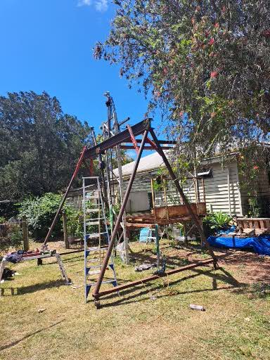

I recently went on Facebook Marketplace and found a heavy duty mobile gantry crane on a farm. The only issue is that for it to be transported from the seller's farm to my place the braces between the A-frames that form the sides and the I-beam cross beam had to be cut. Even with the brace cut the A-frames still extended each side of the truck. Upon its arrival the I-beam hit the ground at an odd angle and one of the braces broke off. The most convenient place to drop the disassembled gantry crane was out in the paddock and the two A-frame legs were lent against a shipping container. The only issue with the 'convenient' location was that there is no electricity connected to the shipping container. With one brace leg broken off and the A-frame to I-beam cross member braces needing welding I needed to reposition everything closer to the shed where I have power connected.
I was going to use a chain block to lift the crossbeam to the top of the shipping container so I could reassemble the gantry crane. The pressing need to bring the parts so I had access to electricity meant that I needed to construct an alternative lifting frame so I could raise the I-beam high enough to attach the A-frame sides.
The I-beam was the first part moved to an already constructed heavy duty pallet racking frame. Some thick walled square hollow section steel allowed me to hook up a chain block. Only trouble was the sides of the pallet racking was not high enough to lift the I-beam up to the height of the A-frame. While I had gained 'proof of concept' and had raised the I-beam successfully, I had run out of lifting chain on the chain block. With this arrangement the I-beam could not be raised any higher.

I wanted everything to be load rated for towing or for lifting. I needed to increase the reach on the pallet rack frame so I looked around for what I had on hand. One of those things was a A-frame for flat towing. I figured if it was made strong enough to tow a vehicle it would have a good safety margin for lifting an I-beam.
The house side of the pallet racking frame was connected to concrete house stumps by 2.5 tonne ratchet straps. I figured a house is a lot heavier than the I-beam. So, that removed the risk of the I-beam pulling the pallet racking frame over on top of me.
More thick walled square hollow section (SHS) crossed over the two pallet beams. I also used cyclone bolts and 8 mm thick steel suspension spring shackle plates to clamp the two SHS crossbeams to the pallet racking frames. I then used similar clamps to fix the towing A-frame to the pallet rack side. Up went the I-beam and I had more height than needed!
The red object attached to the pallet rack frame's highest cross brace is a snatch block. I used it to lift the chain block and later the A-frame up to the top set of pallet beams. From this secure point I could maneuver the A-frame and fix it to the pallet racking side frame. I did not want to be hanging off a ladder and shifting and fixing things like an A-frame above my head.

With all the parts in place all I had to do was assemble all the parts together again.
Lots more ratchet straps to make sure that I did not have run-away A-frames and the judicious use of a ratchet strap connected to my Land Rover Defender as an anchoring point and I could line up the bolt holes in the A-frame and the I-beam.
I thought about how at least the two previous owners of the mobile gantry crane had to cut the side braces so the crane could be disassembled and I figured I could make it a bit more user-friendly. I bought some wider square hollow section that would form an outside sleeve. Then four bolts - two either side of the brace's cut locked everything back into place. I drilled all the holes in the sleeve on a drill press. It was really 'interesting' to be hanging off the top end of a ladder holding onto an electric drill when it bites into the steel and the whole drill jags and starts to rotate your arms.
I used the same specification of high tensile bolts on the brace sleeves as the bolts used to secure the I-beam to the A-frames. Something about having very heavy loads hanging above my head makes me cautious. I tend to increase safety margins accordingly.

There stood a fully reassembled mobile gantry crane!
Next task was to utilise the 'mobile' aspect of the gantry crane and I hooked my ride-on mower to the one of the A-frames and away I went.
The last couple of photographs show the good-old ride-on mower and the positioning of the gantry crane over its first victim ... oops its first job. It is a Series 2 ex-Australian Army 109 General Service Land Rover. See - there is a military link to this whole story after all!
Is it a case of irony that I had to make a lifting frame so I could fill in the gap of my lifting capacity - that required the assembly of a mobile gantry crane. A gantry crane that I bought so I could lift heavy stuff up in the paddock?
Well, I am having a rest tomorrow. The day after that I will be using the gantry crane to do the job it was purchased for. Lifting heavy things out in the paddock.
