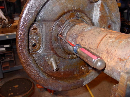

Strange thing you mentioned the drain hole on the rear axle. On my cab 11 one side the brakes were coated with oil, grease, brake fluid and probably some old snott. Anyways the greasy side was far easier to disassemble than the other side which was bone dry and rusted. The cone sheet metal...will attach a picture... was rusted at the bottom because the drain hole was plugged. Rather strange design that rear axle inner seal. Anyways Rob Clarke here has a few spare ones which I will substitute. The brake plate will all be sandblasted and coated with POR 15 before being painted. Will keep the plates black on the inside and OD on the outside. So far all the cams are working fine. On the dry side I had to use quite a bit of heat to free up the star wheel on the emergency brake lever. All will be coated with never seize grease when reassembled.

Old 07-05-05, 04:31
Default Can never do more than 1 pic....
...picture of the drain hole pon the rear axle that should be kept clean and open.....

Had a root around in the parts boxes and the two front swivel seals I found had different numbers. One had original style leather seal surface with no number, but just the word "Outside", presumably on the outer sufrace. Other had newer style neoprene seal and part number 35075. Could this be an updated listing for 35070?
Bob C.
I have a couple of these in tropic wrap/cosmoline with leather seal but there is no part number on them. I understand they were a standard part on heavier Ford Trucks well into the '80s.

Good picture of that rear seal...... mine look like the original leather ones....... so if Ford used them up to 20 years ago they should be readily available..... BUT... not from a Ford costly dealer.
