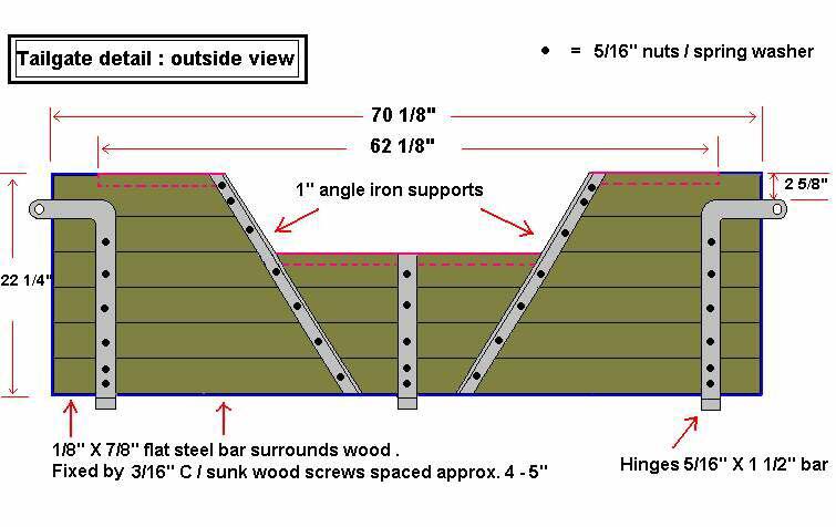

I have started the long process of drawing up the 15 cwt GS body as fitted to many British vehicles 1939-45 .
The web page is at :
http://www.geocities.com/vk3cz/GSBody.html
The look on your various faces will be after viewing the drawings , I failed tech drawing at high school and I still need some lessons

Mike, not bad for a "failure"!
BTW, what program are you using to do this stuff?

Hi Geoff ,
I use the "Paint" programe that comes with any Windows 95 onwards .
Mike, thank you very much for sharing these drawings with us! They are of great help to understand the construction of these bodies. Now, if Rod Diery also does drawings of his No 1 GS Body, I'll have enough information to be challenged into reconstructing a body for the Indian pattern FAT.

Hi Mike,
Your drawings are great. What they lack in technical protocol is well and truly made up with artistic flair and detail.
I would have given my right arm to have had these twelve years ago when I started rebuilding my C15A.

Default softwood 7/8" boards
Mike,
Looking at the drawings, I wonder: could the softwood 7/8" boards originally have had a tongue-and-groove to give the panels a bit more rigidity?

hi Hanno,
The original boards on this particular body I have been measuring from are not tongue and groove , but I believe some makers did use T & G on GS bodies .
These GS bodies were built by various companies so I guess some variation in detail is to be expected .
It would be ideal to have a data bank of drawings for various bodies . In many cases civilian owners chopped up the original bodies on their ex WD vehicles as they were not practical e.g. heavy .
I will be adding more drawings as I do them .

Many years ago Mike Kelly had drawn up the basics of the 15 cwt GS body as fitted to the Morris CS8, Guy Ant, Fordson WOT2 and Bedford MW GS trucks.
Mike used an original Morris Commercial built GS body dating from 1941 as a pattern. The original 7/8" boards appear to be a softwood e.g. pine or fir. The wood has a salmon pink hue and may be Douglas Fir or possibly a exotic pine from Europe. The 15 cwt GS bodies were built by various companies from 1934 on to 1945 and they do vary in detail. It should be noted these drawings were measured from a Morris Commercial body circa 1941 and they will vary in detail from bodies built by other companies.
