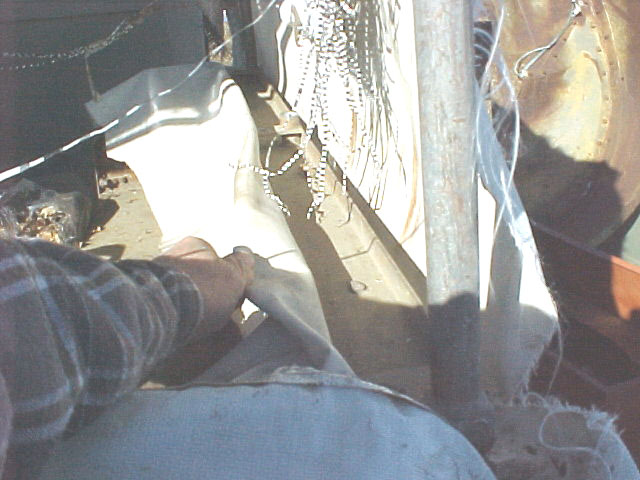

Here's one for Mike Kelly. The picture didn't turn out very good but the top bows are welded to a channel iron that has the flanges pointing up and then the channel is bolted to the box.

I set the locker on the C8 frame today to see where it fit. In the photo at the bottom rear of the cab is a crosspiece that holds the gas tank. There's holes for another one about a foot farther back. Most of the pictures I've seen look like the tanks were mounted on a plank. Would the plank have fit between these brackets or were the metal brackets just a different setup? Also the cab 11 I got this off had running boards where no other pictures I've seen of C8s had them. It was a radio truck (it had the ground straps on all the sheetmetal and the brackets on the locker for the aerial) but there was no frame and the data plates were gone. I also need to know the dimensions for the gas tanks as I haven't found any yet and may have to fabricate some.

Thanks for the pic of the bow setup . Could you please take a some more pics of the detail ? I have been looking for this info for about ten years . Mail them to me at :

Mike, that body is about 150 miles from me but I'll get up there again and get you some pix. Hopefully I'll be bringing the body home with me.
