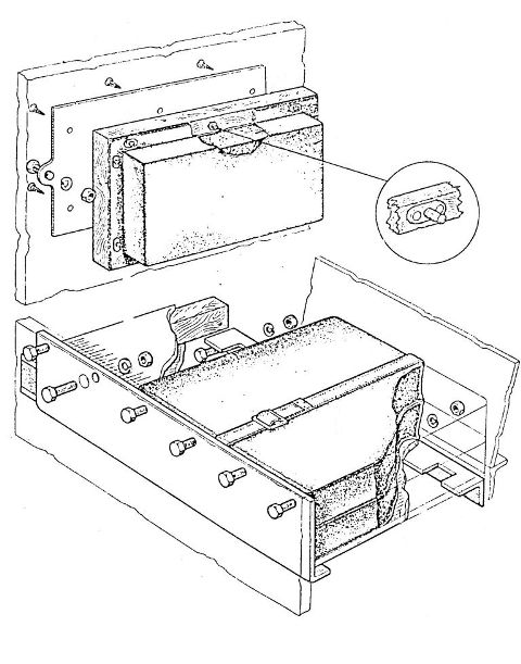

Default Rear seat UC MkI
This is from the parts list for the British MkI, hope it helps.
George.
Old 13-10-06, 00:31
Bob Moseley (RIP)'s Avatar
Posts: 2,620
Default Seat Coverings
Hello Ron
It's a typical upholstery set up with the material wrapped around a wooden base and tacked to those bases. The bases are then screwed onto the brackets. The manual describes the material as "leather cloth" that to my understanding is that brown vinyl leather looking material that used to be on all the old truck seats. Although most of the restored Carriers I have seen have all utilised the khaki green material.

Old 13-10-06, 13:25
ron ron is offline
Posts: 1,294
Default recovered seats,
Hi Bob,
I have been busy today and have made up the wooden seat bases and recovered them in dark green vinyl they sure look good, thanks again for your help.
