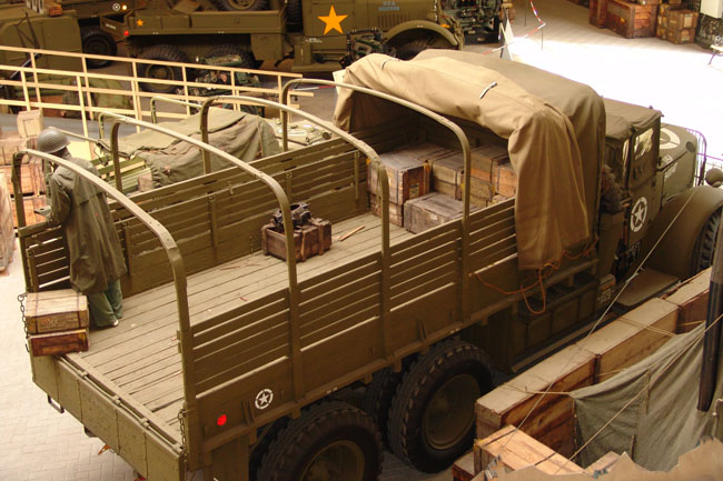

This is really very interesting thread and I am looking forward to see new interesting pictures and comments. Two following pictures show teh Mack NR trucks preserved in two museums, the first is in Overloon (NL) (the same vehicle which was displayed in Zwijndrecht some time ago).
