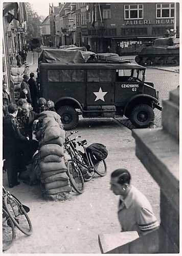

This is actually the Polish 1st Armoued Division in Bergen op Zoom, there is a Cromwell and Crusdader AA in the pic.
Originally Posted by marcel both View Post
About the photo of the square of Bergen op Zoom 1944.
Maybe the C15 wireless truck will belongs to the South Alberta Light Horse regiment.
The SALH were reorganized as the 29th armoured regiment(the South Alberta Regiment) when they arrive at Europe , the SAR was selected to be the reconnaissance regiment of the 4th Canadian(Armouded)Division and after a strongh/heavy fight at the scheldt at the Netherlands, the SAR was with the 4th Canadian(Armuded) Division and took part with the liberation of Bergen op Zoom..
Marcel Both.

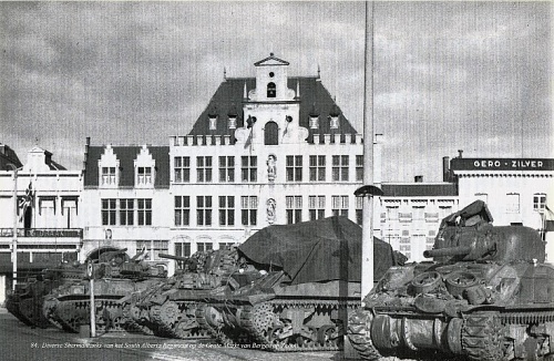

Lance, are you sure? There are multiple pictures of vehicles at the Bergen op Zoom square that are clearly marked Canadian(?). Or, are you suggesting that only the AA-tanks are Polish?
https://www.saak.nl/battlefield%20to...zoom%20(2).jpg
https://www.saak.nl/battlefield%20to...oom%20(16).jpg
Source: https://www.saak.nl/battlefield%20to...recht%20nl.htm

Alex, the 4th Canadian AD and Polish 1st AD were in Bergen Op Zoom, I don't think the Canadians had their Crusader AA's this late, this picture was probably 1st PAD, and or some vehicles from 4th Canadian AD, there are a few pictures of 1st PAD in Bergen, I might be confused, but thought that one was 1st PAD. Unless 4th CAD kept their Crusader AA's, the Canadians did have a few in Normandy, but I don't know if they kept them post Normandy.
