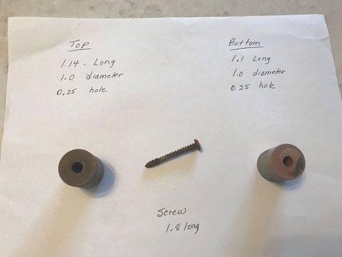

Gord Falk Gord Falk is offline
Location: Steinbach, Manitoba
Posts: 62
Default insulators
My wireless box uses the insulators as shown in the pictures. There are 5 of the slightly longer ones used on the shorter top buss bar and 6 insulators used on the lower lower buss bar. They are attached using a 1.8 inch panhead slotted screw passing though the buss bar, insulator and screwing into the wood paneling. My guess they are either of hard rubber or ceramic.
Gord

Awesome Gord ! Thanks for that . That resolves a mistery . What about the copper buss bar isolators ? That one is quite heavy . I suppose the isolators are beefier ?
44 U.C. No-2 MKII* /
94 LSVW / 84 Iltis

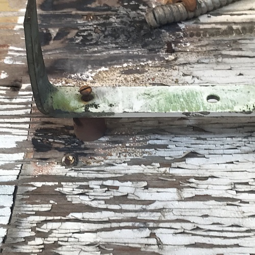

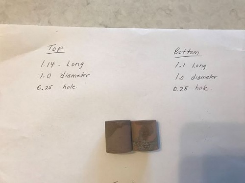

Old 12-03-21, 22:50
Posts: 62
Default Buss Bar Insulators
The insulators on my cadaver wireless box are almost identical for the long buss bar and shorter buss bar. I believe the wiring in the wireless box has not been modified. Gord
Name:	buss bar 12.jpg
Name:	buss bar 10.jpg
(picture attached upside down)

Old 13-03-21, 01:49
Robert Bergeron's Avatar
Join Date: Nov 2012
Location: East Central Canada
Posts: 1,529
Let’s see if this helps. Fabulous Gord ! Now tell us about the lower buss bar going along the front wall under the wireless table please . How far left does it go ? I love that cadaver box , it gives us a lot of interesting , useful,
interesting information !
17FEAAFC-B96D-4D36-A3C8-222CD5451193.jpeg   CB2A0E08-5ECF-49BE-B766-901FF80E4A65.jpeg
