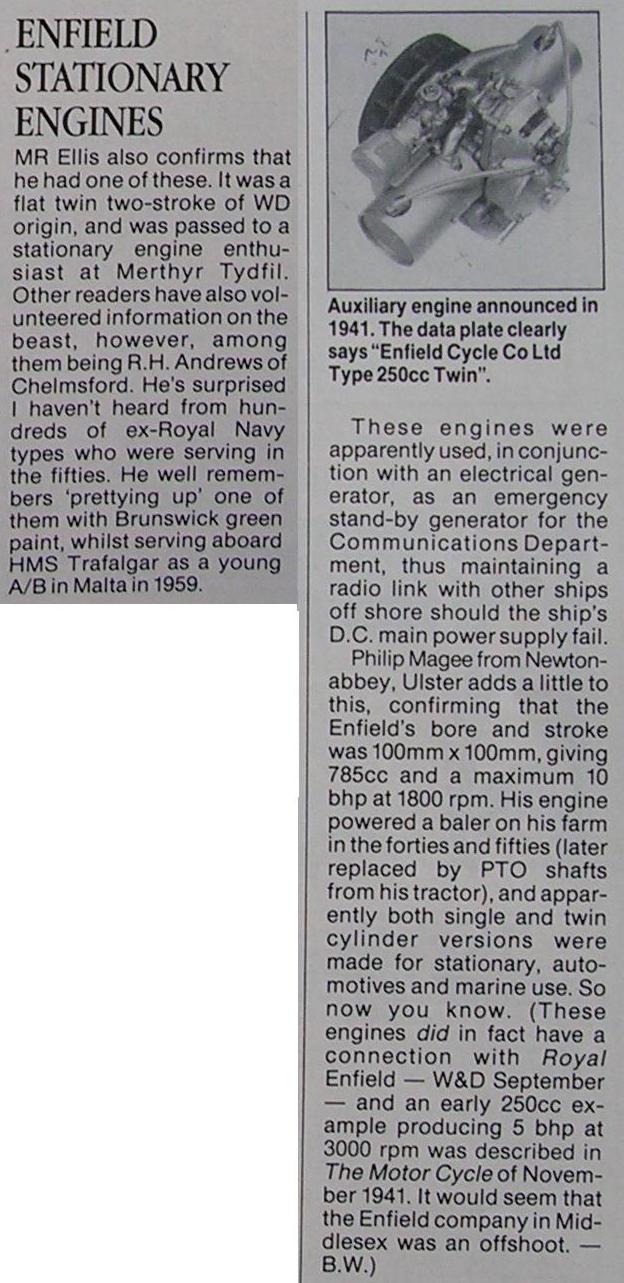

Default more info about the 250cc Enfield twin engine
Neil,
Here's another article from the December 1988 issue of "The Classic MotorCycle".
Jan
