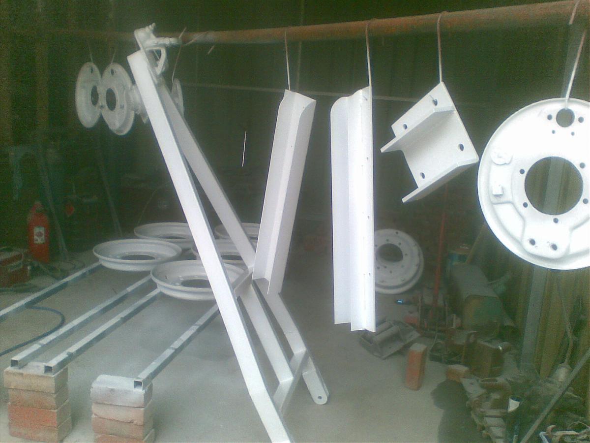

Hi All,
I picked up the rims from the sandblaster on saturday and undercoated them all as well as a few other parts.The wheel cylinders,shoes and new brake lines were picked up also after sleeving and bonding.I am going to top coat the rims in the next few days so i will be picking up the tyres ready for fitting.If i get some time this week i will have all the brakes/hubs back together after a package arrived today from Ross Prince with all the seals,master cylinder etc.I had a brake concentric setting tool made by Shepard Thomason CO in the work shop from the days of my 69 Mack Flinstone.These tools are used for getting the brake linings concentric with the axle a must for 100% contact.So out it came back in service it goes.Just goes to show if you keep something long enough you will use it again.I finished mounting the winch,new seals etc also.In the photo there are a couple of non cmp parts as i had an under coating frenzy.The A frame is to suit the C15A as i planed to flat tow it but floated it instead. Until next time happy restoring. John Stokes

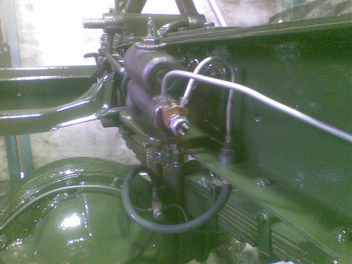

Default Brakes all working
Rain sent me home early today so straight into the shed to work on the C15A.I installed the kit into the NOS master cylinder and fitted the remaining pipes and hoses.Filling the master cylinder with fluid and a bleed here and there it was all good news. I removed the tie rod ends and cleaned the threads and adjusted the toe in something wasn't right.It seemed not to have enough turning angle.I thought about it for a while as i disconnected the drag link from the RHS hub still not the same as the left side.Then the penny dropped the backing plate retaining bolts were fowling on the knuckle.Pulled the drum off shortened the bolts and everything is fine.Not sure if this was always like this or i had lost the shot bolts.The old saying comes to mind check,check,then double check.

Default Area around master cylinder
Hi John
Looks like you are making very good progress, as you will probably remember the area around the master cylinder gets crowed with brake lines, fuel line, wiring harness, battery cable and the speedo cable. It also gets very hard to work in once the engine is place.
So now is a good time to get the routing for each of these figured out and locations for all the cable/tube clamps located and sorted out. Consider putting all of the cables and lines in place even if you just put the clamps in place loosely.
I mention this as I had major problems with my Pattern 12 when the speedo shorted out on the brake light switch lugs. Burned out the speedo cable, battery cable, wiring harness, and almost through the RUBBER fuel line, about the fuel line be sure to run steel through this area. Cause for all the problems was that I didn’t have all the locating clamps in place on the speedo cable.

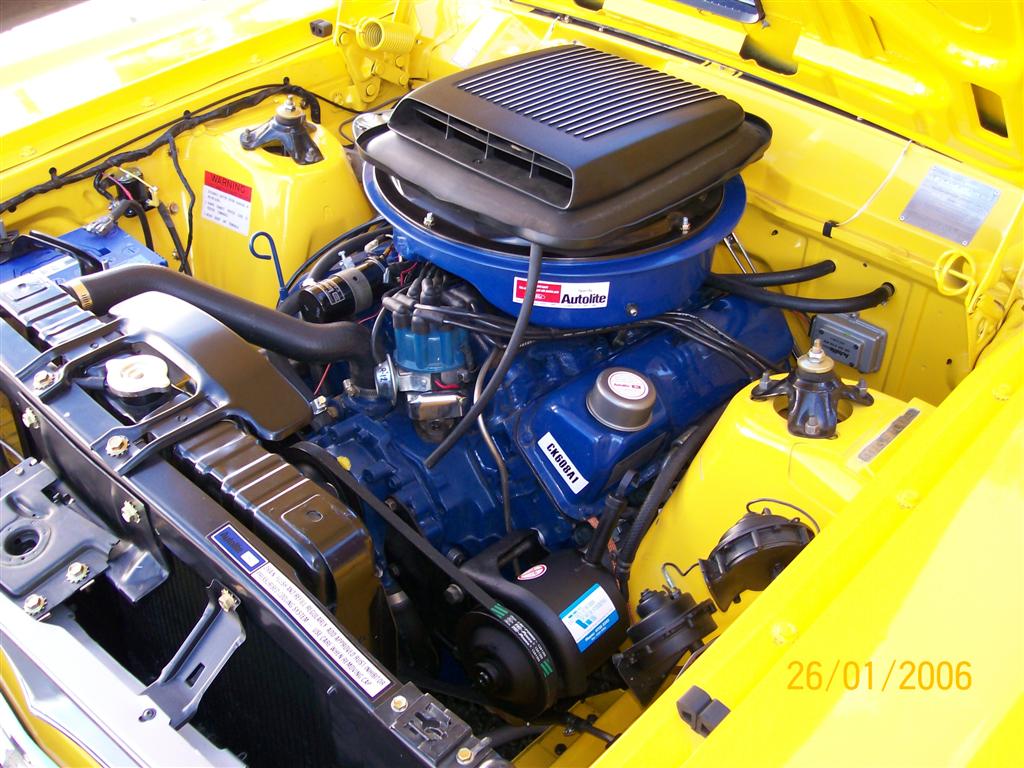

Default Ugly Falcon For Howard
Hi Howard,I will post a couple pictures but the Blitz is the flavor of the month.Keeping in mind this took two and a half years and 3 jobs at a time to pay for it! That is why i say i am happy to do the C15A more realistic.Image 001 is not shown you will have to open it.

XY GT? Nice!
Old 06-10-08, 12:45
Default Xy
XY GT? Nice!
CMP = even NICER

Originally Posted by John Stokes View Post
...Keeping in mind this took two and a half years and 3 jobs at a time to pay for it! That is why i say i am happy to do the C15A more realistic...
Yeah, I know. The XA is going to take a LOT of work. Well done with the GT! I bet it sounds even better than it looks!!!!!
