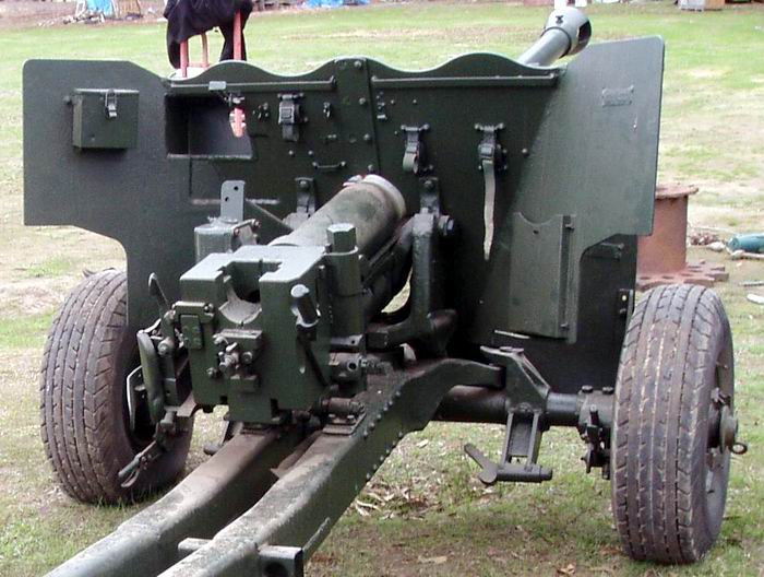

Missing from the Gun when we got it, among other things, was the Elevating Arc.
Without this Arc, the barrel just wonders up and down with nothing to retain it when the trails are open.
After many an email and what felt like an eternity (about 2 years which probably really isn't that long - I bet some of you have waited longer !!) the part was finally found.
A HUGE THANKS must go to Gary A. in the US who finally tracked one down and sent it over here. I can't thank him enough for all his help and assistance.
I am so happy (and relieved) that we finally have another (major) piece of the puzzle solved.

Hi Darian, if I only knew you were missing that part. One just got sold on ebay for $12.
YEAH RIGHT
Keep up the good work, Looking good.
Colin.

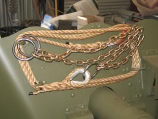

I repro the drag rope (made from components just like in the M1 gun manual (last pages) See picture $68 US + ship....or pick up at MVPA National from Rod Shaver's booth (Scout Car Rod)....I have four rectangularly spaced bolt holes on lower left shield - looks like it matches the holes on the "lube order or records holder" on your right shield (backside)...also have four hopes on upper left shield - no idea what goes there. Ideas?

Your Drag Rope/s look really good and Thanks for the offer of Drag Ropes but we already have them.
The four holes on the inside left upper sheild are for the "Spare Parts Box". Not really a very big box for spares - I guess they figured they would be very reliable!!! Positive thinking!!!
If you need any measurements, etc, of the Lube / Record Holder let me know and I'll measure it up.

I found matching holes on the RIGHT side shield!!!! That's the same box I have too! Holes of left side shield form a vertical rectangle with long (vertical) side 3X width!? Guess standard lube order would go inside holder on lower right shield (inside) - below where my box is mounted.......also, there are two footman loops on my shield on left side front - up high besdie the door that opens to the gunsight - any idea?
The footman loops on the lower hinged shield appear to be for the pick handle but with the shield up - it would hit the rounded carriage 'nose'??!!

This is from the 1st A/B in California, Gary Archer owned the gun, don't know if he still does.
http://imageevent.com/gazzavc/6pound...kvxzg1.zebra_s
I know they reproduced the lower shield...
