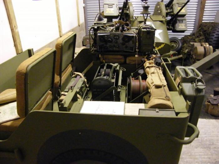

Can't remember where I got it from, had this for a few years.
Lance

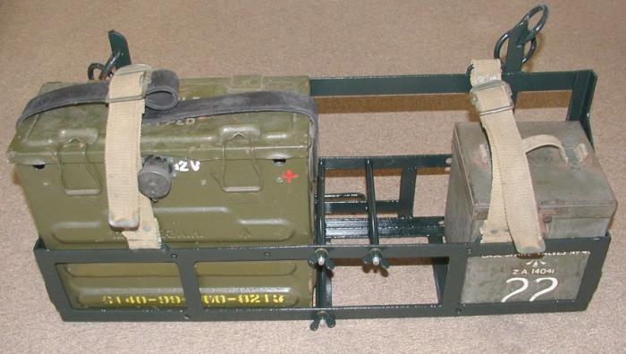

Some more..

Hi Lance
Thanks mate, that was what I was looking for. Very much appreciated.

No problem, glad to help.. I threw the 22 set one in there too, just to compare.
