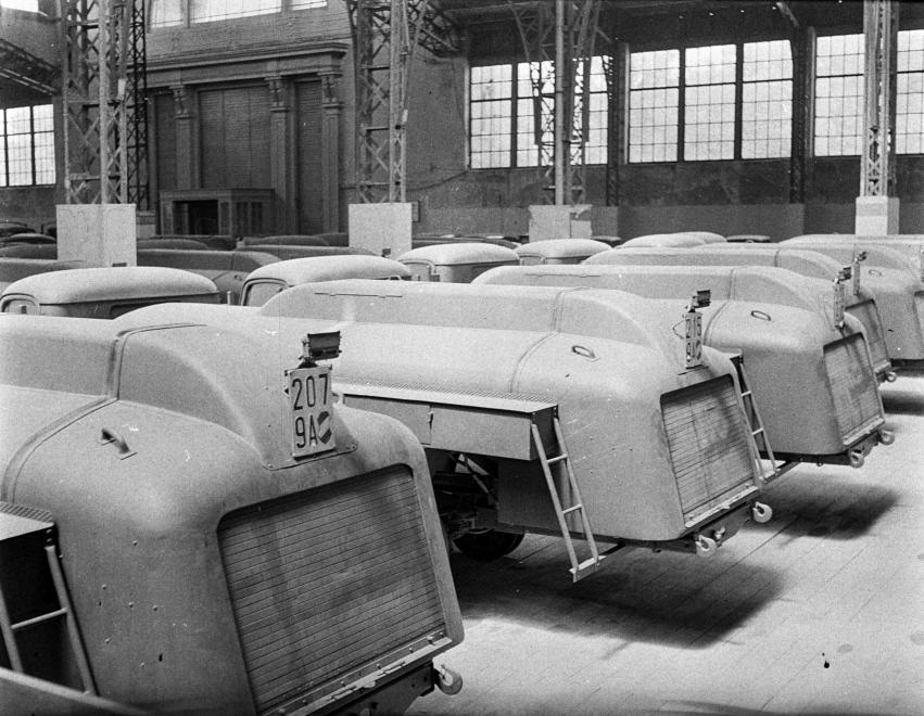

Interesting thread, can't add much besides that fact that the picture indeed shows a Dutch "Pag-trekker" (AT gun tractor). I would not be surprised that they ended up on the Eastern Front, will look if I can find any more.
For comparison I added a factory shot of Ford-based PAG-Trekkers
