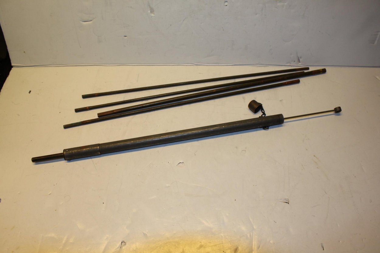

Hi
I have recently acquired this wireless set 58 and was given this set 19.
I was hoping that I could complete the set no 19 as a ground/truck station (hence the wireless table I have made) so I am looking for the remaining items and a manual (digital copy would be fine) so I can see what hooks up to what.
I have some cables (12 pin and antenna) for it but they are all very long or very short? Also the PSU 6 pin socket has been converted to a civilian socket so I am looking for a replacement.
I also found this set 58, but think I am missing a battery box and some antenna sections, but like wise I am looking for the remaining parts and a manual.
Would any one be able to help.
Cheers niels

Batteries for this set haven't been made for decades. They were also notorious for short shelf life. Best bet is to make your own. Voltages needed are +1.5V, +150V, +90V & -21V. The EMER F702 shows pinouts of the octal socket.
I can't recall where I found this but here is a photo of the original battery.
Two other alternatives are the PSUs made in Italy. They seem to work quite well.
http://www.ebay.co.uk/itm/PSU-6-o-Vo...oAAOSw6DtYUscw
http://www.ebay.co.uk/itm/POWER-SUPP...QAAOSwcUBYOVVr
