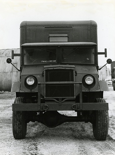

David,
A very interesting tidbit. Mike Kelly shared this photo years ago, proving not all cab roofs were fitted with a hatch as standard. Indeed quite a few photos can be found of plain roofs.
CAB with hatched roof - optional all models ?

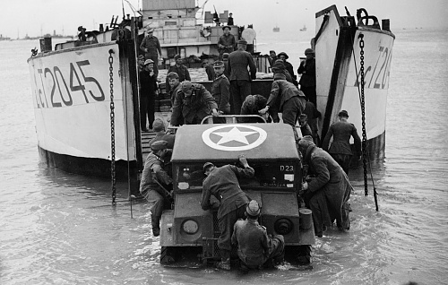

Not all CMPs had hatches added - they were optional after all:
1016px-German_POWs_help_unload_a_jeep_from_a_tank_landing_craft_near_Ouistreham,_Courseulles,_11.jpg
German POWs help unload a jeep from a tank landing craft near Ouistreham, Courseulles, 11 June 1944.
Artist: Parnall, C H (Lt), Royal Navy official photographer
Description: German prisoners of war helping to unload a jeep from LCT 2045 on the beach near Ouistreham, Courseulles.
Date Taken on 11 June 1944
Source: https://www.iwm.org.uk/collections/i...ject/205187118

Yes, easy to install. The objective of this thread is to demonstrate that not all CMPs had an observation hatch in the roof as it was an option. Many did, but not all of them had one fitted in the factory or while in service.
