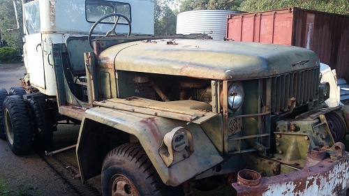

We have had sitting at home (Perth Western Australia) for the last couple of years an early m35/36 LWB cab chassis;from what i have been able to glean so far it is a STH BEND Studebaker built Diamond reo M36 with chassis/frame number of M36 366.

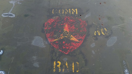

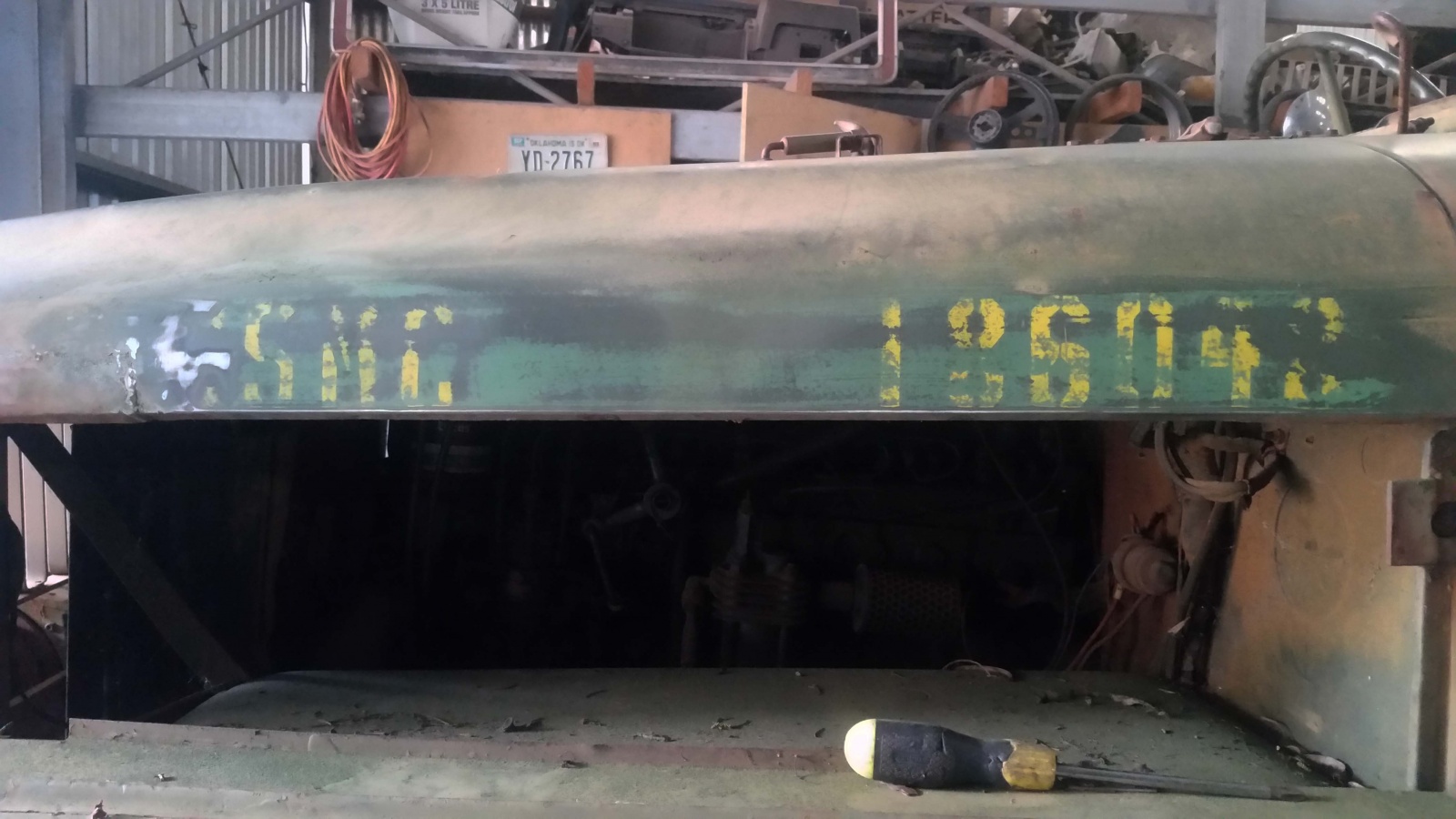

All of its data plates are missing presumed souvenired by past operators,i have just rubbed back the bonnet/hood area and have found in approx 2inch yellow lettering USMC 168048, rubbing thru door reveals a red symbol with yellow3 bladed sort of fan affair with COMM HQ RAD arou.

Originally Posted by john piercey View Post
I have just rubbed back the bonnet/hood area and have found in approx 2 inch yellow lettering USMC 168048, rubbing thru door reveals a red symbol with yellow 3 bladed sort of fan affair with COMM HQ RAD around it.
It is the insignia of the 3rd Marine Division, stationed on Okinawa since the Korean War era, with a short tour (4 years) in Vietnam. COMM is for communications and RAD is for radio. Each division had a communications or radio battalion as part of its make-up.

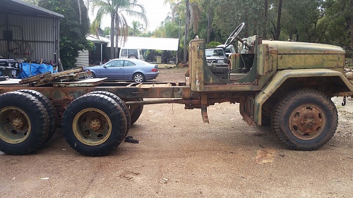

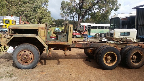

The photos don't look like it's an M36 chassis. They are 3 feet longer, and the distance is quite visible. With the swapping of cabs or data plates over the years, it's possible they got swapped, or the chassis shortened.
The Canadian trucks have a serial number on the frame over the front left tire, and the model of the truck was part of the serial. Not sure if this applies to the older trucks or were the result of more recent manufacture.

Hi Rob,Yeah i thought it was short but never having seen a picture of a long one i thought it must only be an inch or two difference,frame number says M36 -366 is on lhf side of rail behind wheel so i dont know ,theres not a plethora of them over here to compare with,but it may well have been shortened to better suit the drill rig which was once fitted.

Looking at your photos you can see a very big difference,i will inspect chassis rails and see if there are any matching holes for suspension setup.
I have just checked frame rails and cant see any matching holes to suit that pedestal mounting pattern,rails appear to be original with no stitching in of new lengthening sections all crossmembers have their original rivets and not bolts which may have suggested repositioning,approx wheelbase measurements from centre line of front axle to centre of spring saddle/pivot point is 154 in and to centre of rearmost axle is 178 in,i will have to try and find orig measurements of a standard WB and compare those

I have just checked the "standard" wheel base measurements and they match perfectly,so am still confused?oh well
