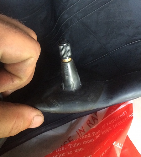

I started to mount my 9.00 x 16 tires today on my rim but I’ve run into a problem. I believe the tubes that came with the tires have the wrong size valve stem.
What is the correct valve stem for the 9.00 x 16 tube to fit in the CMP rim?
This is the stem on the tubes I got.
ID:	102020 Click image for larger version

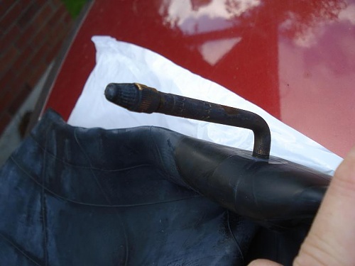

Hi Jordan, this is what I have.
Found a better picture.
Robert Pearce.
