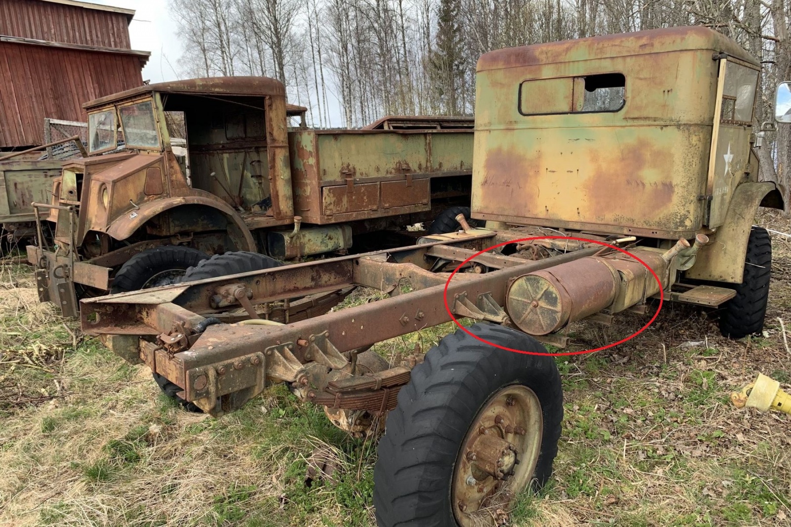

Default trailer air brake line
In the CMP Service Bulletin book there is a write upon trailer air brake line being installed on the CMP frame.
Here are some photos of the air brake line setup on a C60S in Sweden.
Doe anyone have a manual on this trailer air brake line setup?

Old 18-05-20, 15:22
From what I can see, I would guess the truck shown above is more likely vacuum brake assist with vacuum brake for the trailer than air (pressure) brake. I base this on the little bit I can see of the lines to the cylinder and under the cab. The flexible connections look like simple hose clamped to tube which is more typical of vacuum than air brakes. Having said that, I believe air brakes of the WW2 era operated on lower pressure than current trucks so I could easily be wrong.

Old 18-05-20, 17:56
I know this is getting picky but that is a vacuum brake system for the trailer as opposed to air (pressure) brakes to go with the vacuum boosted system of the heavier CMPs. It does make sense to use the same power source for both. Also, I'm not aware of any CMP equipped with air (pressure) brakes except some trailers (usually towed by larger vehicles than CMP 3 tonners). As always, happy to learn more - even if it proves me wrong....

Old 18-05-20, 20:04
Default Trailer air brake line
I know this is getting picky but that is a vacuum brake system for the trailer as opposed to air (pressure) brakes to go with the vacuum boosted system of the heavier CMPs. It does make sense to use the same power source for both. Also, I'm not aware of any CMP equipped with air (pressure) brakes except some trailers. As always, happy to learn more - even if it proves me wrong....
Grant, you must be right.
I thought I had seen pictures of the trailer air brake line setup on this forum before. I recalled it was for actuating trailer brakes, not boosting thr truck's brakes.
If it was a pressurised system, the truck would have to be equipped with a compressor but I see no signs of that.
