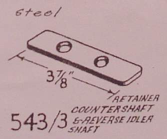

File Type: jpg bottom plate rear engine mount 543-3.jpg (9.6 KB, 451 views)

543/3 is nothing to do with the mount. It is (as it states) the plate that locks the two press fit shafts in the back of the g/box. It's about 60 mm long and about 3mm thick.
I dont know what
O1T-5101 is but somebody will be able to tell us what the 5101 relates to.

Yeah I realised after I had posted that 543/3 wasn't the part that I thought it was, but thanks for explaining what it does.
There is, however, a bottom plate for 543/2, perhaps this is the Ford part 5101????.
