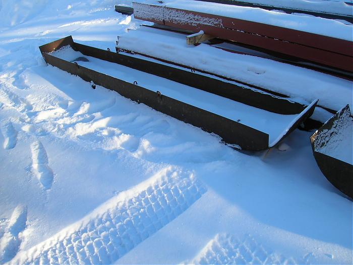

Hi again
I have now found a guy that will help me recover the UC. He owns a Bombardier snowmobil or something and dont think it will be any problem driving over the ice.
As the UC is over 4h drive and 0,5h by boat from where I work Iīd be thankfull if anyone could help me with the following:
1, How broad are each track?
2, How broad and long is the UC in total?
3, How much do you think it weight in itīs current state? (See pictures in the beginning of this post)
4, Does anyone have any drawings of an UC with measurements?
My plan is to put a U-beam under each track, the U-beam will be bent up in the front like a ski. This will hopefully give the UC a better "glide".
Thankfull for any input.

Thought I would add to the information being suggested. If I was towing the carrier over ice I would try and keep tracks on. The ground force is spread more and if the ice was going to crack it would be less likely to do it under tracks than under the road wheels, so I would keep tracks on in that case! Build skiis and put carrier on them and tow her home!

Well I will try to recover the carrier in the end om march if everything falls into place. I have found the perfect skies behind an abandond barn and will do the nessecary adjustment to fit the carrier. See pictures.
Any input from you are appreciated. Scale is metric.

I would first take a trip out to the carrier and pack a road to it with even a snow machine. It would freeze deeper. Also when I went to get it I would tow it with a long cable (15 meters.) to spread the weight out. You don't want the two vehicles too close together.
