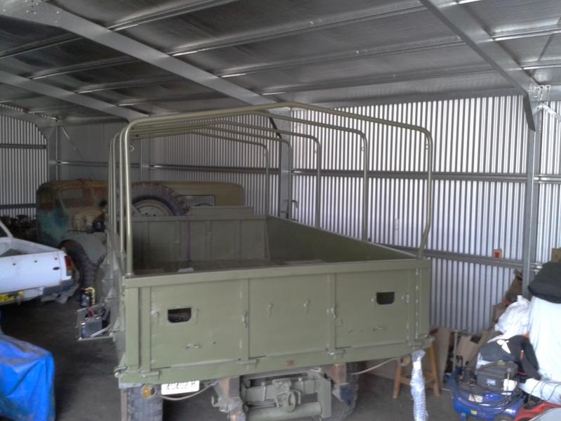

Default It started about...
Just after the sides were done. What do the bows look like?
Do they come as individual bended tube or are they an assembly all joined together?
After much wild goose chasing I realised the answer was much closer to home.
Back out to the farm where the truck was originally from, to see if there was any remanants.
Bingo! we found a bow! But was it original or not?
  #278
Old 18-03-15, 13:07
Ganmain Tony's Avatar
Join Date: Jul 2009
Posts: 1,246
Default Well..
Ok.... it certainly looked right and fitted in the holes of the sides OK.
But the conclusive evidence came when we noticed a bit of flaking rust on the top.
Hang on! That aint flaking rust, thats a plate!
A quick rush around the shed, find the wire brush, a quick hit and viola!
TRUCK 3 TON GS D ^ D.
I'll take it as conclusive evidence that this is the original thing.

Default Cheating..
To the guys that like to do these things themselves... I freely admit I went to a steel fabricator to have these done.
Heavy wall pipe was used and a bit of research to show how the bend was done on the rearmost bow.
The boys did a fabulous job

Default Thanks Lads
Robert, I think its slowly dawning on the hound that its not a bad thing and not a bad kennel. Makes a good man kennel anyway.. I'll keep working on him.
Thanks Alex, thats correct, no interlinking with this type of Bow. There are other types I have seen that do - but not these.
I was lucky with the Jewels... If your nice to people, nice things can happen. Thanks again Steve - they really were a generous gift.
Matt - good question, I can only give theories based on observation and research. If your truck had a steel body like this - yes these are the bows but I have seen joined sets that also fit.
If it was a timber and steel composite body as I have seen on nearly all the civvy type cab trucks then probably not. The bows on these types of bodies sit on the outside in clamps bolted into the timber sides. So while the dimensions of the both steel and timber bodies may be the same, the bows for the timber ones are slightly wider.
I'll try to get some dimensions to you shortly for this body. Sorry I missed you at Corowa. Next time, just butt in. Nobody minds.
Ryan - thanks mate. Yes it was done by local trimmer and his wife. More pictures and info to come.
