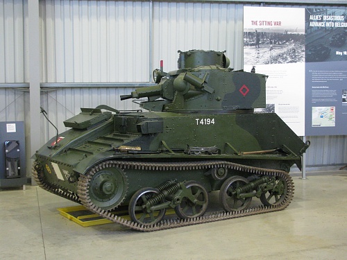

Hi Colin,
Don't you ever sleep??
Here is a photo of one at the Bovington which I had a good look at when we were there in 2009.
Regards Rick.
