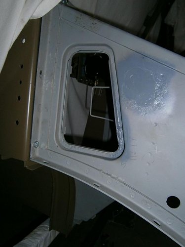

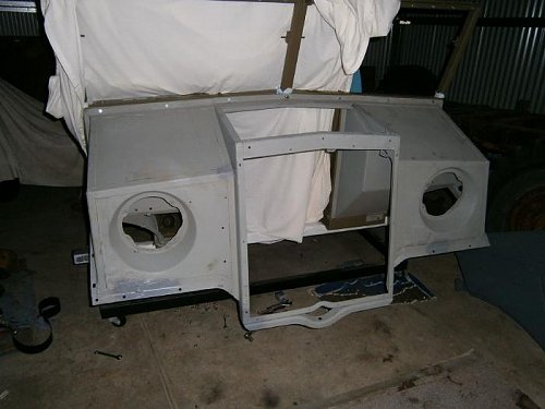

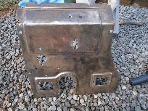

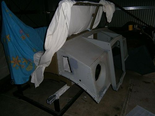

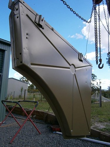

Default Nose Panel - First Trial Fit
Had a few things to do in town this morning. The bolts still haven't arrived and the shop didn't seem too worried about it. I managed to get them a little more motivated, after a brief chat.
As previously mentioned, I have become increasingly interested in trialling use of molasses. I priced it today at the local rural supplies store, and was very pleasently suprised to hear it is 66c/litre! Pity the car won't run on the stuff After a brief search around Gympie, a suitable storage container was bought, and I now have 20L of the stuff ready to use. I wish I had the trailer on, I could have had a 44gal drum to use as the dipping tank too. If only I had a Leyland P76, I could have brought it home in the boot of the car. At some point tomorrow, I'll mix up a batch to dip the two shackles from front bumper, which are well & truly frozen solid. If it frees them up, I will be very impressed.
Name:	nose first fit 4.jpg
ID:	48020 Click image for larger version
Name:	nose first fit 3.jpg
ID:	48021 Click image for larger version
Name:	nose first fit 1.jpg
ID:	48022 Click image for larger version
Name:	nose first fit 2.jpg
With insufficient day left to set-up and start welding, I settled for a trial fit of the nose panel to cab frame. After a little manipulating, it's sitting OK for a first attempt, but I have marked several areas for slight adjustments and the odd hammer blow to get better final fit. Any welding needed on the nose was done weeks ago, so now it only requires cosmetic touches prior to painting and fitting.
Welding & repair work will commence on drivers door tomorrow. If lucky, that work may be completed by stumps. I won't be watching the clock though.

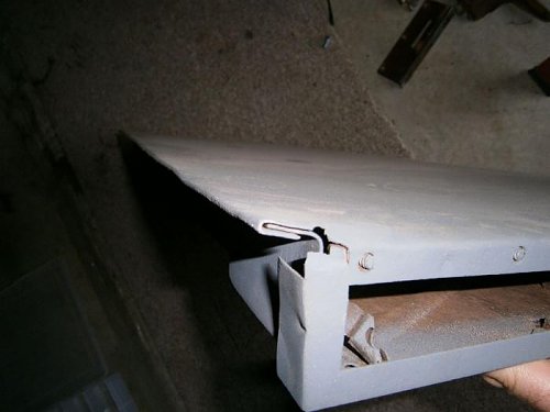

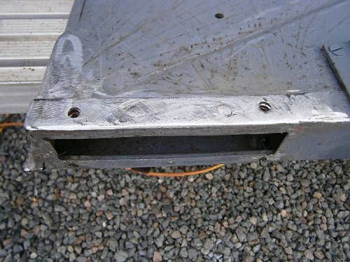

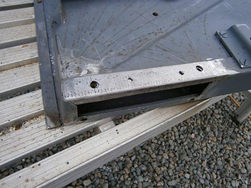

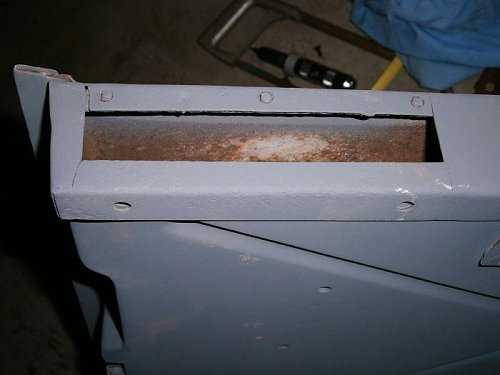

Default Drivers Door Repairs #1
Name:	Driver door 4.jpg
ID:	48056 Click image for larger version
Name:	driver door damage 1.jpg
ID:	48057 Click image for larger version
Name:	driver door damage 2.jpg
ID:	48058 Click image for larger version
Name:	driver door damage 3.jpg
ID:	48059 Click image for larger version
Name:	driver door repair 1.jpg

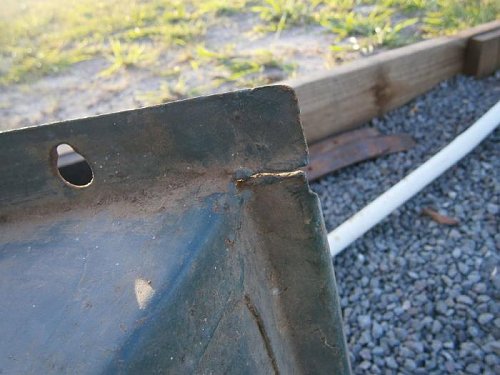

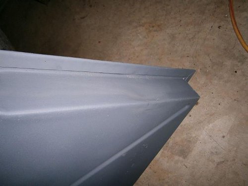

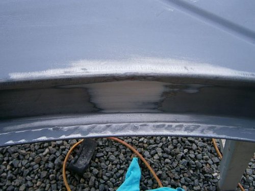

It took 6 hours, but the door is almost done. I still have to apply some filler to outside skin, where I welded up 6 holes. The poorly repaired section on hinge inside edge was worse than I had expected. Once the old 'repair' was removed, the full extent was seen. I considered replacing the whole strip along this side, but settled for a massive amount of re-welding, inserting two patch plates and a light skim of body filler to cover some grinding lows.
More to come!

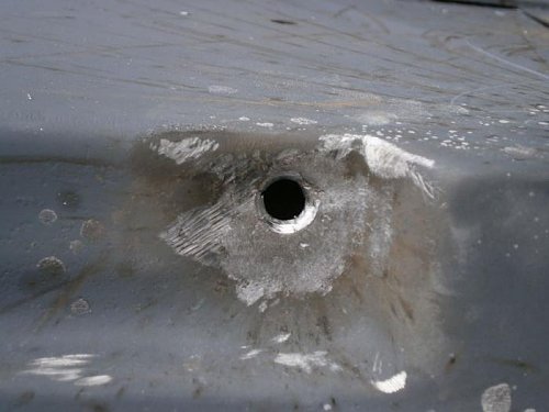

Default Drivers Door Repairs #2
Name:	driver door damage 4.jpg
ID:	48061 Click image for larger version
Name:	driver door repair 2.jpg
ID:	48062 Click image for larger version
Name:	driver door repair 3.jpg

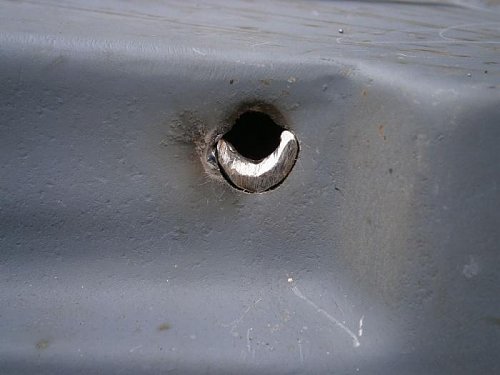

This tiny little countersunk hole caused me the most pain today. I attempted to just apply weld to create the rough profile and finish with a good filing. Every time I touched the area with MIG, I blew the hole bigger, so that method ended fast. Finally settled for manufacturing a new countersunk hole (or 1/2 of one). The shape was easily formed using a broken flathead V8 intake valve head placed onto a pre-drilled piece of sheet metal, and belted repeatedly into a length of soft wood, until a 'countersink' was created. A small magnet inserted into door, held the patch in place for welding.
Welding it on wasn't as hard as I had expected, but here's where the pain comes in. A weld spark managed to get into my welding helmet, bounce off that, and into my ear! I promptly exclaimed 'oh darn!', or perhaps something ever so slightly more ribald. To be honest, the actual comment contained a reference to the son-of-god and a speculation on potential dubious parentage. Oh well! What doesn't kill you.........makes you angrier.
The hardest part of this repair, was in flattening the weld back to panel level. The grinder couldn't be used because the area is too tight.
More to follow.

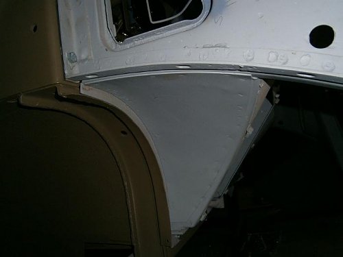

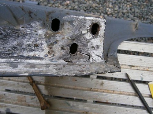

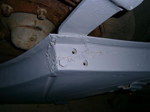

Default Drivers Door Repairs #3
Name:	driver door damage 5.jpg
ID:	48064 Click image for larger version
Name:	driver door repair 4.jpg

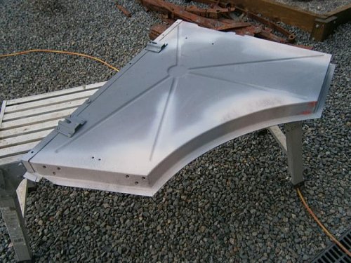

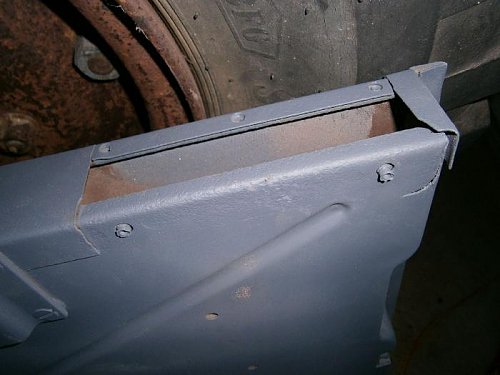

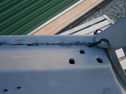

The sandblasting revealed a dent along to lower part of lock edge. With time getting away from me, I decided against my original idea to weld a plate to the low spot and lift this out with a dent-puller. A 4 inch strip of body filler had to do in this instance. I don't like doing that and am trying not to dwell on it, or I might be tempted to grind it out and go with original plan.
Name:	driver door damage 6.jpg
ID:	48066 Click image for larger version
Name:	driver door repair 5.jpg
ID:	48067 Click image for larger version
Name:	driver door repair 6.jpg

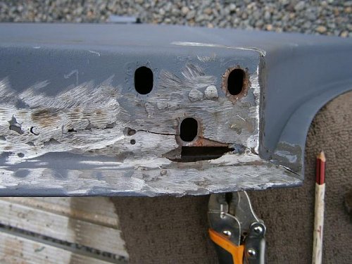

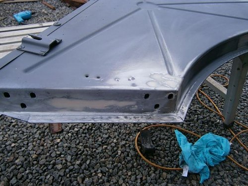

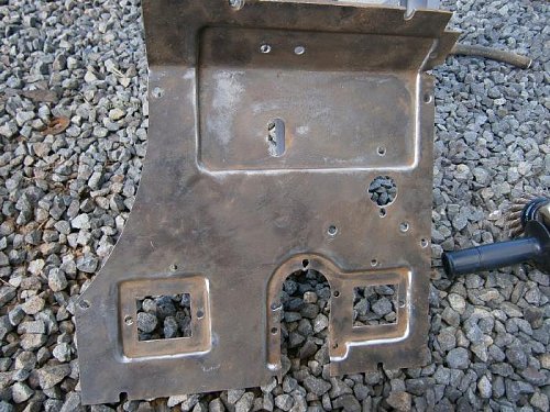

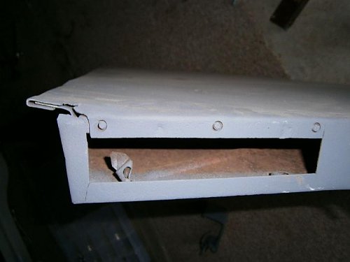

Every corner of the lock access opening was cracked, in some places very badly. The missing bit remained missing, despite a lengthy search in my original shed. If you remember, I removed that piece when door hardware was stripped months ago and put it in a 'safe place'. It is still safe! In it's absence, I had to make a new piece to weld in. The middle two holes are a minor design improvement I added for strength. Through these holes I welded the repair patch to the door frame, making the area a little more rigid. I also applied a small spot of weld around the corner, in hope of holding the little 'flap' a little more firmly also.
Last part to follow.

Jeezus, I hate panelbeating!

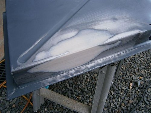

The inside of door is now all primed, with spray putty & stop putty applied sparingly. The outside will be to primer stage next Saturday, and weather permitting, door will be painted on Sunday. Hinges are the next thing to tackle. They will need fresh pins.
I am considering sending the roof for blasting soon, to see what evils lay in store there. No plans to start work on that yet, but pays to be fore-warned with these things!

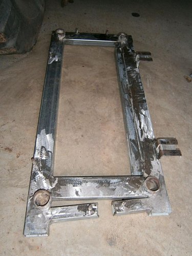

Old 25-03-12, 19:35
Default Front Door Hinge Repair - Suggestion
Hi Tony
As you have figured out fatigue failure of the front doors of Patter 13 are extremely common. What is even more annoying is when they reoccur several years later. Hope to have found two of problems causing the occurrence:
Welding up the crack on the outside doesn't really get the inner plate well attached. The inner plate were originally spot weld in place before the out side door skin was applied. One solution to this is to drill through the outer skin but not through the inner plate then plug weld the drill holes which welds the inner and outer layers together.
The other cause of the re-occurrence of the fatigue crack or a loose feel to the door is a little strange, failure of the spot welds of outer skin where it is folded around the inner door panel. Tried rewelding with a pinch spot welder no good, just enough rust in the folded edge to prevent good weld.
Solution was again to drill and plug weld the three layers of steel as both sides are exposed, drilled 1/4" through all three layers every two inches near the hinge. Then with a brass heat sink against one side just welded the holes up and ground them smooth.
Re-occurrence of cracks also seems to happen when a fatigue crack is just welded up. I've been told that with cracks it is important to actual terminate them by drilling a small hole just past the end of the visible crack and then to actually cut the crack open to a with of 1/16 or even 1/8 of an inch then weld the joint up. This is supposed to be particularly important if the crack is to be ground smooth on one side. What has peoples experience been with this approach?

Old 26-03-12, 17:32
Default Door hindge backing plate.
Hi Tony
Just went out to the shop and looked in the doors of the HUP through the lock assembly hole. Both doors have full length plates which is much heavier gage steel than the door shell.
One of mine my backing plates was loose enough that when drilling the holes it started pushing the backing plate away, so stuck the hinge in place with the bolts to hold the layers tight together while drilling and welding.
Fix the front hinge area on my HUP for the first time some 25 years ago, so if the 2nd repair last as long I won't complain much.
The loading on the hinges of the front door of the Pattern 13 are ridiculous because they are placed so close together. Interestingly the side and rear doors of the HUP have a hole at the bottom of the door that would allow you to slide a new or additional plate in. Not sure what that would do to the hinge alignment though.
In the picture below you can see cracks in mine drivers side door, you are looking at the lower hinge are, if you look at the where the outer skin is folded over you can just see a little line of rust which is the area of movement between the outer skin and the inner door panel.
I'll try to remember to gather all of the door hinge before and after photos an post them on my web site.
Hope this is of help to you and others at this point in their Pattern 13 restorations or ongoing maintenance.

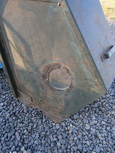

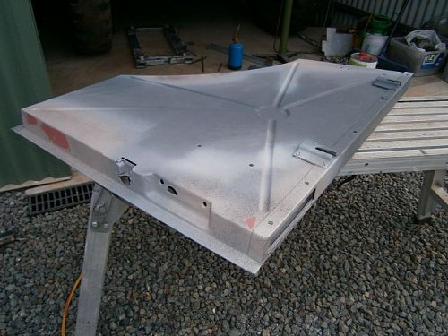

The second (passenger side) door has now been collected. I had always considered this door the worst condition, and while it is certainly in a bad way, I don't look at it with the same anxiety I did with driver side door. Still needs its share of working though!
This one has a small but quite defined dent on the outside, about 1/3 down from the top. This I will certainly lift out part way with a welded stud and slide hammer (or whatever I can find to use). When applying filler to a flat panel, it is best to try to support from the inside to stop the flexing that occurs. Repair work is more likely to be without a visible border once painted. Because the door lock access opening is not the full size of door cross section, I will use/insert a wheelbarrow tube and inflate to fill the space. An old panelbeaters trick, tought to me by an old panelbeater! Jeezus I hate panelbeating
I will also incorporate Phil's Technique to stabilise the inner hinge plate.
Speaking of hinges, the 2 from this door are in great shape, and wil not need to have any attention.

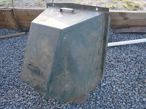

Default Spare parts for doors
Name:	spare doors.jpg
I have these three damaged doors for parts or donor metal, such as the piece that will be needed to re-plate a section of passenger door arch. I just checked, and do have a pair of replacement hinges for driver side, so won't need to re-pin the originals.
I do still need the bolt-on plate around driver side catch release lever. If anyone has one for sale I would like to hear from you.

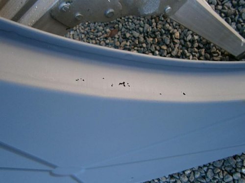

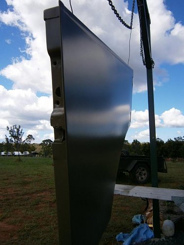

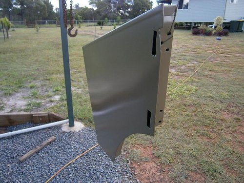

This afternoon I was making the remedial repairs to drivers door hinge side, as recommended by Phil. I drilled a total of 9 holes to strengthen the door from future cracks, and also made three spot welds along the edge of the skin where it overlaps the inner frame.
While doing this, I was thinking through the forces & mechanics that would have caused the original cracks (now repaired). I kept coming to the conclusion that there must be more to the problem than I already understood. While pondering, I began to examine the hinges themselves. Thats when I discovered a rather devious little flaw with the hinges, or top hinge to be more specific.
Consider the upper hinge as three parts, one that bolts to the cab frame, one that bolts to the door, and the hinge pin as third. I found that when I moved the upper hinge to the 'door closed' position, the two parts came to end of travel BEFORE the door would have been closed. Only just before, but the hinge parts met in a certain place and would go no further, no matter how much force was applied. This would mean that the door itself would have had a load force placed on the frame to complete the close. I checked another door (also cracked) and saw that it too had this issue. I checked a third door, that did not have any cracks, and the hinge pin was worn to the extent that more movement was possible between the two main hinge parts. This hinge did NOT butt up in the same place as the others had because the worn pin permitted additional movement.
I had initially intended to replace the pin on the drivers door (passenger side was OK) but found a good set on another door in my spares. On the top hinge that will now be for drivers side, I used the angle grinder to remove a little of the height that caused the binding I had described above. This hinge now has a travel of another few degrees. I suspect this may relieve one of the contributing factors to future fatigue of the door frame. I will know more once the door is painted and fitted to the cab itself.
Drivers door and hinges will be painted tomorrow (weather permitting) and I will let you know how things go once hung in place.
I made the repairs to door outer surface this afternoon as well, and must say I am somewhat disappointed to find the door skin had a slightly dished in appearance that I don't believe I can remedy! It is not a dent as such, but may be a result of years of slamming the door. I will have to live with this unless I get brave enough to go ahead with an idea I had to have pressure applied from the inside to force the skin permanently out. It wouldn't take much, and I considered using a small amount of expanding foam in a plastic bag to do this. This would be sound in principle, but theory doesn't always hold in practice. I'll wet sand the door and see how it looks after that.

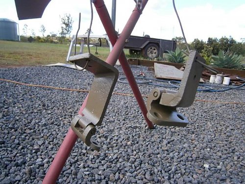

Default Todays progress #1
Cheers guys! Im grateful my hinges aren't bent. Thats something I suppose. Both my doors (ones being used) also had the stop straps with them. They are old and hard, so I will look for something to replace them at the local rubber & foam shop.
Name:	driver door painted 3.jpg
ID:	48155 Click image for larger version
Name:	driver door painted 1.jpg
ID:	48156 Click image for larger version
Name:	driver door painted 2.jpg
The day was clear and sunny, so I got the door painted. Despite the strong breeze and painting outdoors, I couldn't find any contaminants inthe paint!
Name:	driver door hinges painted 1.jpg
Also painted the hinges, headlight rims, fire extinguisher bracket..............
ID:	48159and an old hat
I have since misplaced the hat. Bloody camo paint!
More to come.

Name:	pedal plate 1.jpg
ID:	48161 Click image for larger version
Name:	pedal plate 2.jpg
Pedal plate has been beaten back into shape, ready for blasting. A minor rust repair job will be done at same time as I do the passenger door.
ID:	48160 Click image for larger version
ID:	48163 Click image for larger version
Today was the first time I have looked critically at the engine hatch. There are two cracks at top corners and a hole has been cut in the passenger side. Apart from that, it's in really great shape. Whoever cut the hole was then followed by someone who wanted it gone again, because a patch had been screwed in place at some point. I will weld this up once blasted. I think I will send these pieces for blasting either tomorrow or Tuesday.
To top off an already satisfying day, a friend of mine phoned late this afternoon to say he had found a Ford CMP brake booster (in the box) at a garage sale, and asked if I would like him to buy it on my behalf.
You can guess the answer to that one!
The passenger door repairs and these other little welding jobs will happen some time over the Easter break.
