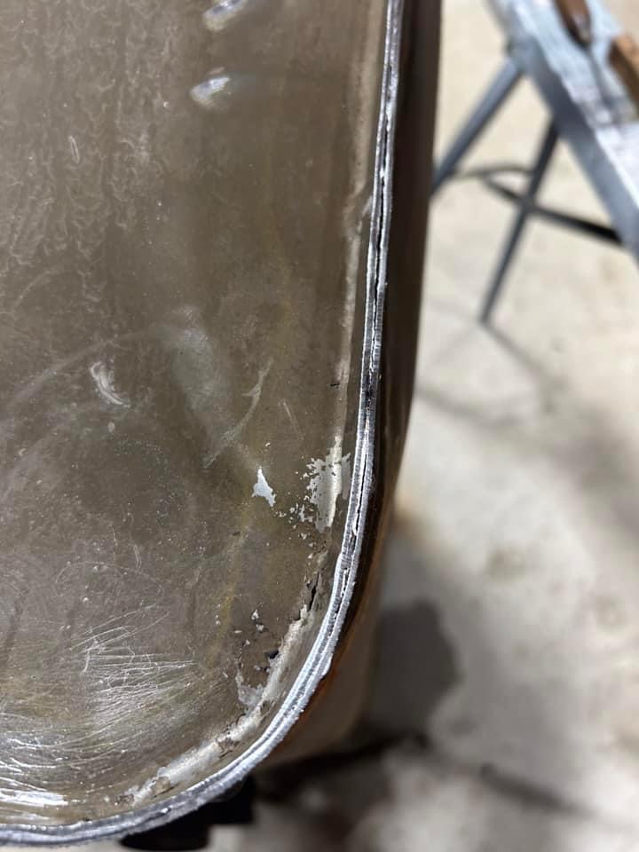

Removed the ends of the fuel tank. At first I tried melting the solder out and uncrimping the edge. It wasn’t working too well and was making a mess of the edge. I ended up using the flap disk in the grinder and simply took the top of the fold off. This went very quick and I was able to remove the end panels. They will get formed back into shape. As suspected the internal baffles were popped from a few tank walls. I will remove them as well. This will give me the access I need to get the rest of the tank cleaned up. This will also let me work on getting the side walls of the tank back into shape. I also removed the senders and the pickup tubes.

The end plates and baffles were removed and straightened up.

The tank looks quite decent inside. There is one spot to patch up, but otherwise it’s quite solid. It will be a bit of work getting the creases out and everything back into shape.
I’m contemplating buying a kids wading pool to make up a dipping tank to chemically clean up the tank. I figured one side can soak at a time and it can just be rotated.

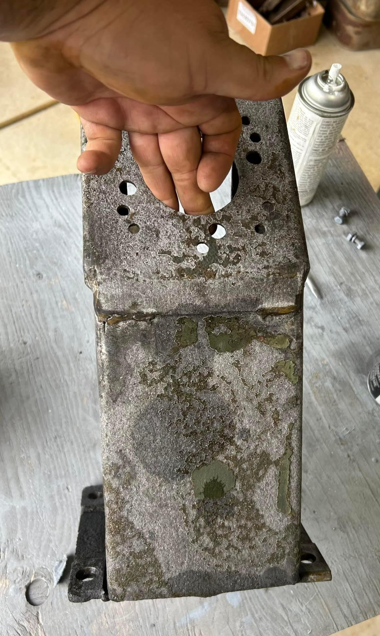

For the past 4 days or so I’ve had the drivers seat base soaking in the citric acid bath. After power washing the seat off I was quite happy with how well it cleaned up. I know in the picture it still appears quite rough, but other than some variation in metal colour, the rust was gone. I decided to give it a once over I the blasting cabinet and it came out very clean in a minimal of time. I also cleaned up the early style seat runners.

That's a neat method for heating up the citric acid/water solution , a fish tank heater
Just wondering how the ends of the tanks can be re-used after the top edge of the folds have been ground off ?

The 90 gallon fish tank heater works great in the 40 gallon bath.

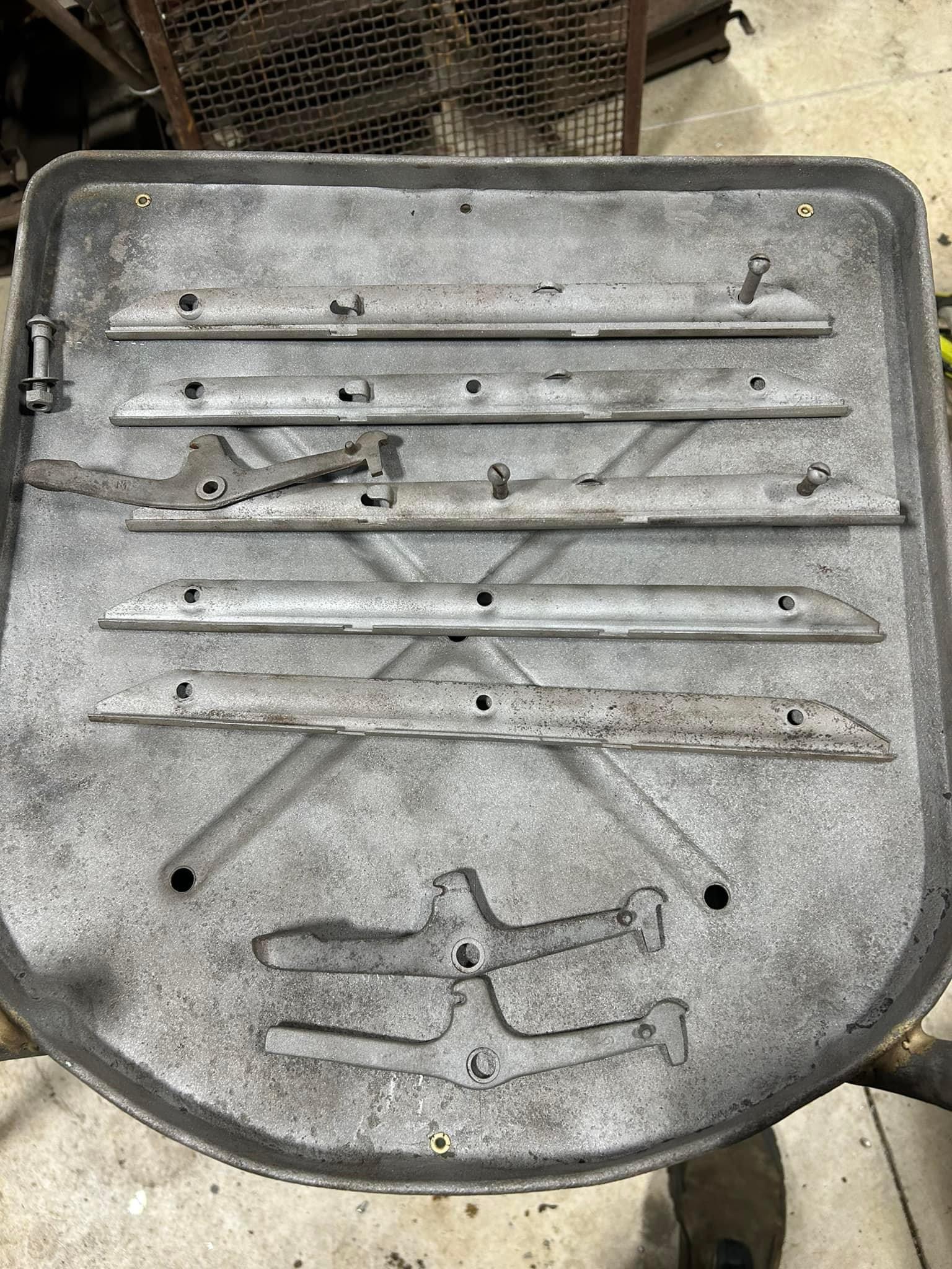

Parts being prepped for painting. Most of these are for the radiator shrouds. Also some side and brake light mounting brackets. The larger parts were all cleaned up after soaking in the citric acid bath. I’ve also created a caustic bath for removing all the paint. It’s working great as well on the parts that don’t fit in the blasting cabinet.

Lastly some seat parts all painted up. The turret seat is now mounted on the basket frame. Interestingly it used square headed bolts and nuts. The originals were too rusted out so new ones were used in place.

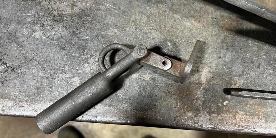

Pretty happy with how this small handle for the seats is coming along. The original was cast. The one I’m making was cut out from a piece of flat steel bar. Just have to do the mounting hole.

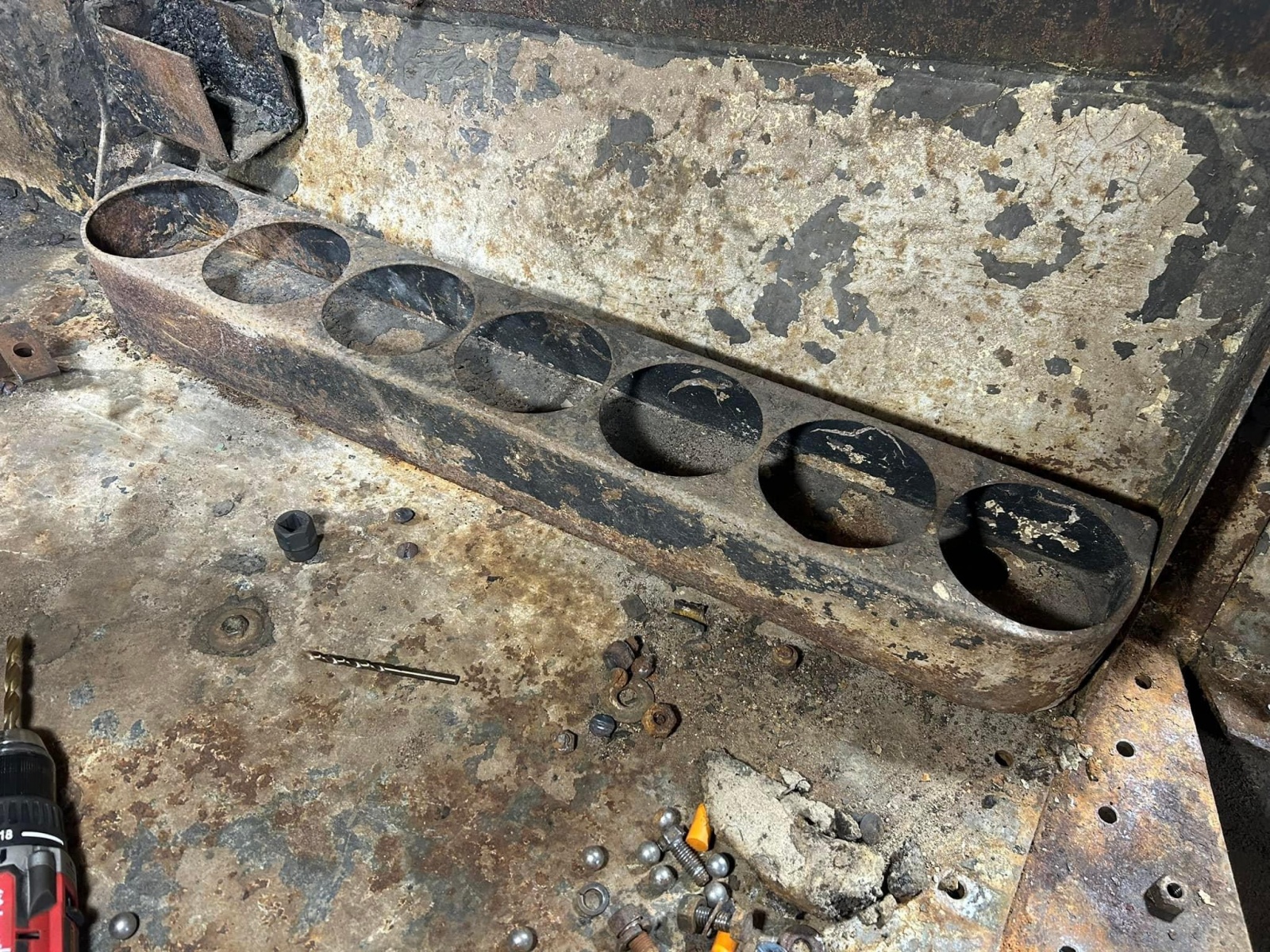

Got around to removing the smoke round rack. It was held on by two bolts that did not want to come out. I ended up drilling the heads out. This part is in pretty good shape and will clean up nicely. The awesome surprise when I lifted the one end up…..some 303 casings.

In total I found 7. Four of them are 1943, one is 1942 and the last two are 1950. I was hopeful they might have been fired during the war. But the two 1950’s dated ones have the same strike pattern as the others suggesting all were fired by the same Bren. Regardless it is still a great discovery.

Looking at the .303 casings and the shape and positioning of the primer strikes I would suggest that three different Bren Guns were involved.
The 1942 case has a central strike, smaller than the others.
The 1943 cases have a strike near to the edge of the primer pocket.
The 1950 cases have a slightly different strike position just off centre.
The maker's head stamps are different for each of the years so I'm convinced there were three different Brens.
It is very likely that the 1942 and the 1943 cases were fired during the war years.

The 1942 case looks to possibly be a British Kynock case. The 1943 cases I think may be Canadian Tracer rounds (D1 Z )and the 1950 cases are Belgian FN (Fabrique National) rounds.
Also the ejector marks are different for each of the years.
