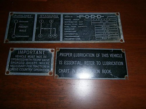

Moving on, I received the info plates that go on the engine cover, that I had bought from David D. Bloody good condition they are too. I gave em a light tickle with some silvo and removed a small amount of age related soiling. The photo really doesn't do justice to em though. They are very nice. Thanks to Keith, I know the shift plate isn't 100% correct for the type of transfer case but I will attach this plate for now.
boom shanka!
That's great, but in Ford info plates for cab 13 you planned to have some reproduced? Please do so before you attach them to the wrong vehicle. As you know I am looking for a set of plates, and will seriously consider a set of reproductions.
Thanks in advance!
  #456
Old 24-05-12, 23:34
Default Hanno
Re: Info Plates
I think what you mean is that I am intending to reproduce copies from suitable originals.
The shift plate is not good enough for reproducing, while the lubrication and front drive plates could be, especially lube plate.
I have taken high resolution images of those & sent to several photo / etching companies. Not heard replies yet. In the meantime, they can rest on my engine cover, held with screws, for easy removal when required.
If the shift plate is what you are after, find me a good plate for me and i'll gladly swap it over!
P.S: As far as I know, only the shift plate is not correct for my truck?

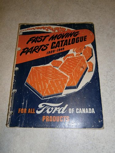

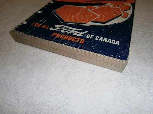

Default Ford Fast Moving Parts Catalogue #1
ID:	49382 Click image for larger version
My "Fast Moving Parts" catalogue arrived today. Covers in quite good condition, and inside pages don't look like any grease monkey has ever thumbed through it. It's a good inch & 1/4 thick.
Looks like this is the company that originally owned it, and this stamp appears in a number of places throughout the catalogue!
ID:	49385 Click image for larger version
No specific mention or diagrams of CMP, but lots of part 'interchangeability' evident. Part numbers written clearly and quite often has an accompanying line drawing or illistration.
Cont'd..

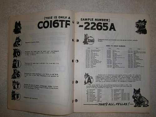

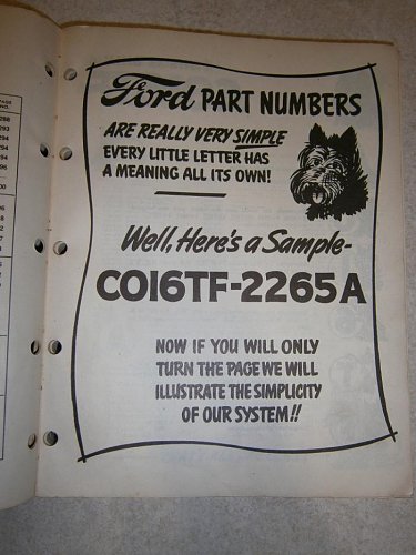

This is the start of a lesson in how to read Ford part numbers.
I have dedicated the next (and final) post of the day, to all the specific instructions on reading part numbers.
Hopefully it may be helpful in some way.

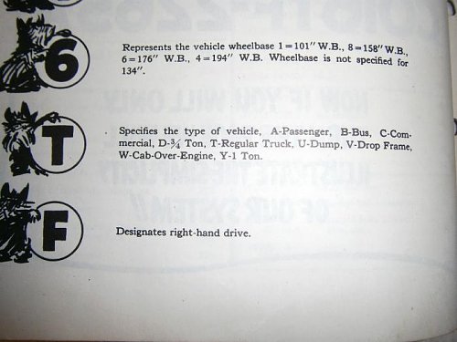

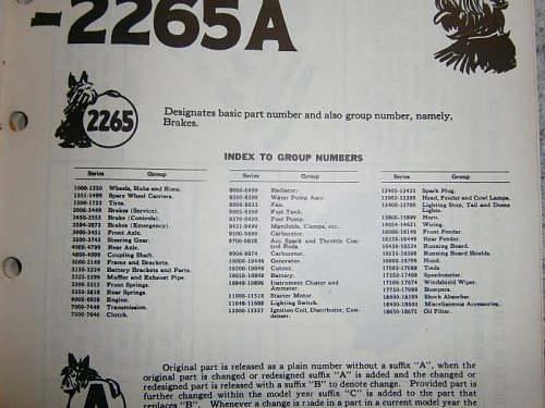

  #459
Old 25-05-12, 12:22
Default Reading Ford Part Catalogue Numbers

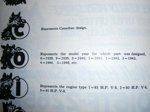

The following information is photographed from an original Ford Fast Moving Parts Catalogue, Canada, 1928 to 1949.
Name:	reading parts 1.jpg
Name:	reading parts 2.jpg
Name:	reading parts 3.jpg
Name:	reading parts 4.jpg
Name:	reading parts 5.jpg
As the book says...........That's All, Fellas!

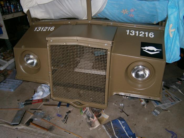

  #460
Old 26-05-12, 13:03
Default Little Progress Today

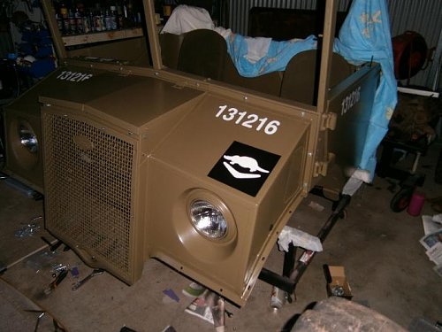

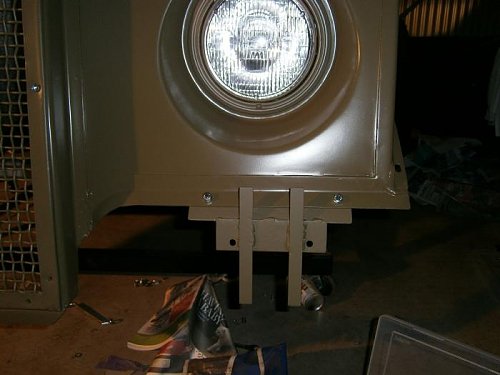

As I spent morning and early afternoon in town, not much got done on the truck today.
Name:	bonnet & grille 3.jpg
I did manage to get the bonnet / hood on the nose, using two small shims to raise the hinges slightly. The reason it looks to be sitting too high in the front is because it is sitting on a roll of tape to stop it from taking paint off front edge. The bolts holding cross piece of nose panel front hit against the bonnet. I will remove each one and whittle the head thickness down to about 2/3 of currect thickness. It won't hit then!

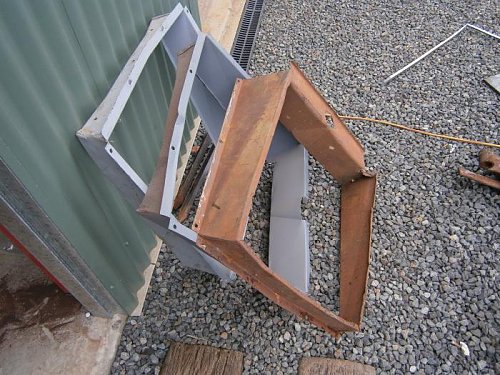

Can someone please tell me what these holes on upper cross piece of nose panel are for? I am hoping they are to take rubber grommets for bonnet to sit against! If they are, it will assist me greatly. If not.........crap, i'll have to find some other way of keeping bonnet still so it doesn't take more paint off.

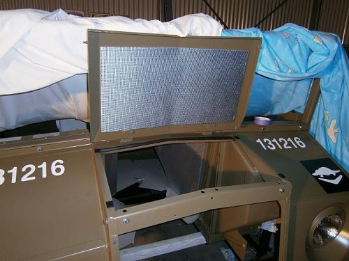

I also made a little heat/acoustic shield for under bonnet. Not greatly concerned about heat there, but the added bulk should minimise 'drumming' of the sheet-metal.
Look at all the bloody paint I lost when first testing bonnet fit last weekend. It's the same on both sides too!

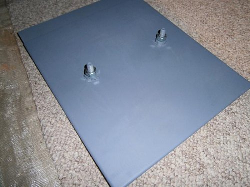

Name:	TAC plate bolts.jpg
Had enough time in the bank to get the bolts welded onto back of the front TAC plate holder. Last night I was playing around on the computer, and narrowed down fonts for unit signage and 'PASS' sign.
More on that in next post...
  #461
Old 26-05-12, 13:41
Default Holes
You are right, Tony those little holes are for rubber bumpers which you can still get from a good rubber supply company. Your insulation under the bonnet means you can't paint the nomenclature there - I think you'll find there's so much other noise a little drumming there is insignificant.
Attachment 49420
Attachment 49421

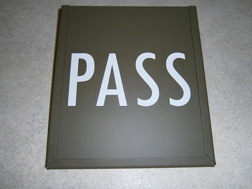

  #462
Old 26-05-12, 13:51
Default TAC unit & PASS design

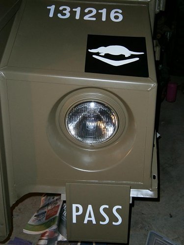

After much playing around with different fonts, these are the ones which may suit. The military directions regarding font size and type are making it VERY hard to keep this historically accurate. When using the correct height and width of font for the unit numbers, it fills the entire plate, leaving bugger all space either side. And thats with a font that is still a little smaller than specified. This problem is due in no small part to the signage I need for my Fathers unit, 29-46 Inf Btn.
It's a bit like 'Goldilocks'
Name:	TAC sign 4.jpg
This one's too small.....
Name:	TAC sign 5.jpg
This one's too big....
Name:	TAC sign 6.jpg
This 'bastardised' version, while not entirely following the regulations, does match two similar plates I have seen in original photos where the unit had a lot of numbers to fit on the plate. So I guess this one could be......Just Right Maybe. I'm over it for now
Name:	TAC sign PASS.jpg
On a happier note, this mock-up of the PASS side of the plate looks just about right compared to the drawings as shown in military regulations documents.
Once I settle on my requirements, I will take the 'mock-ups' to sign cutting place on Monday afternoon. They will probably tell me "Oh no sir, we don't have any of those fonts. At which point I will strike them roughly.....and run away laughing insanely
  #463
Old 26-05-12, 13:58
Default Rubber bumpers
Thanks Keith,
I was hoping that was the case with those holes.
I'll call into the local rubber shop next week.
I was in two minds about the sheeting under the bonnet too. I thought about it for a long while and came to the decision that I won't worry about the under bonnet writing. The poor old truck is now made up of so many trucks, and the chassis shortened to something between F60 & F15 length, that I wouldn't try to represent it as any particular spec. I will assert it to retain a 1942 build year, but even that is drawing a long bow if you stop to think of the numerous parts that must be from other years. Mind you, those dates are rarely identified for certain.

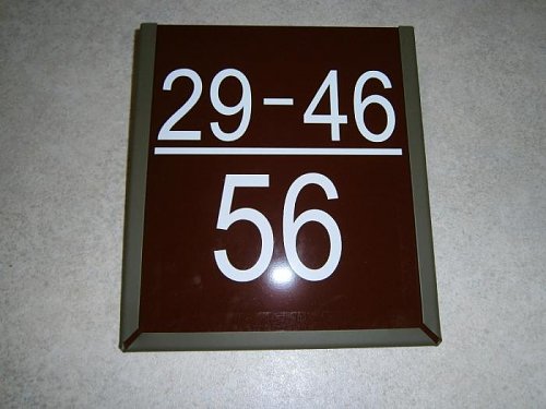

Old 27-05-12, 12:59

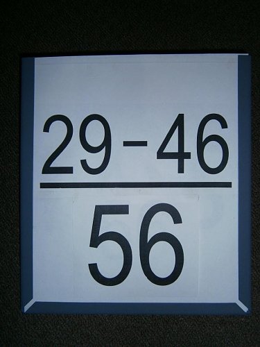

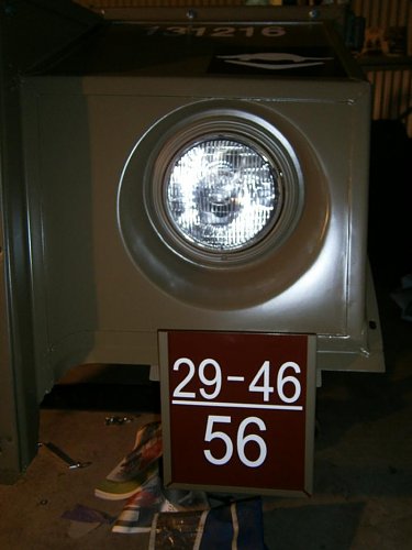

Default 29/46 Battalion unit sign - odd discovery.
Having remarked that the applicable unit sign I am using for the restoration looks like a mathematical problem, I decided to 'work it out' for my own amsement. Calculators are a wonderful thing
I was astonished to find that while the 'answer' was a negative number, it worked out to be the EXACT calibre of the Lee Enfied rifles carried by the soldiers. That being .303......etc.
Isn't that just the strangest thing!!!

  #471
Old 01-06-12, 13:01

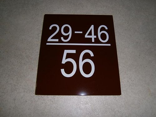

Default TAC Sign - signwriting has arrived
Name:	TAC sign - Unit side.jpg
TAC plate signwriting has finally been delivered. This evening I painted the red background of the 'unit' side, cooked it for 15 min with a hand held floodlamp, brought it inside and applied the unit numbering.
Tomorrow I will paint the other side of plate & plate holder in vehicle color, and plan to apply the PASS lettering tomorrow night. Working on a way of eliminating abrasion between plate and holder when the plate is moved in/out. I have a 'cunning plan' though it may turn to night soil.
Bought an airbrush yesterday, for painting of light scratches and anything 'new'.....bolts etc..
While in town tomorrow, i'll be calling in on the local wrecking yard, in search of suitable rubber bumpers for the bonnet to rest on.
  #472

As a matter of fact, I just put the data plates on engine cover this evening. That is not an issue, because they are screwed into position. I felt it was better to attach them to a highly visible part as opposed to putting them "in a safe place" which always gets forgotten. I had made enquiries to a couple of places in Aust. who may have been able to reproduce the plates. Only one replied, and they weren't that interested, citing the imperfections as a difficulty, and indicating it would add greatly to the cost. Something about the touching up to improve quality. Stuff 'em then

Old 02-06-12, 13:37
Default TAC plate finished
Name:	TAC sign - Pass side, finished.jpg
ID:	49643 Click image for larger version
Name:	TAC sign - Unit side, finished.jpg
FINALLY finished this bloody thing.

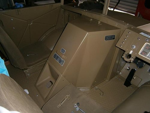

Put the grille temporarily (spelling??) onto cab this afternoon to protect it, after nearly having it 'cop a whack' from a falling piece of steel. Got motivated to move it quickly after that.

With all the stuffing around on the TAC plate, I decided to purchase a ready made bridge loading plate with an appropriate load rating. The seller in UK has NOS bridge plates (9") for 18 pounds, including the load stencil in a range of fonts to suit. Should be on its way to me Monday. The sample pic shows different font to one I have chosen. Should be able to make a suitable bracket for it and for TAC plate tomorrow, weather permitting (I only weld outside).
My radiator shrouds will checked tomorrow, to see which one is best to use. All have some form of cracking and/or panel damage. If my welder (and welding) was better, I might make one really good one from the three I have. No hope of that with current skill level though!

Old 03-06-12, 13:19
Name:	Tac bracket.jpg
ID:	49688 Click image for larger version
Name:	TAC finished 1.jpg
ID:	49689 Click image for larger version
Name:	Tac finished 2.jpg
I'm sick of talking about these, so here's the photos. Whoopdy do!
Name:	Engine hatch 6.jpg
Would you have a look at the color difference between the two parts of engine cover! They are from same paint can, and painted on same day with same pot full of paint. Only difference is the variation of finish. Lower part was previously painted and only got an additional 'final' coat when painted second time (with large part). You can't actually SEE any variation with your own eyes, but the camera makes it look completely different color. Matt VS 'lustreless' finish is the culprit. With that in mind, I tried an experiment with the TAC plate bracket I made today. I used some of the 'old' paint I had from the painting of nose panel, which I had kept for brushing onto new bolts and scratches. It was getting a bit 'cheesy' but OK for this little project. Sprayed it REALLY dry on final coat, and YEP, have a look at the color when photographed. Looks nothing like that with the eye. Bloody smart arse digital cameras.
I also found that there is a slight difference between the catches of bonnet and engine cover. Engine cover has a slightly longer travel length. I found this when attempting to install the catches I thought were for bonnet, and found I had painted the wrong ones. Ran out of day for rectifying this...........and apathy took hold .
I have been offered a Sunshine Roof for virtually nothing, and would like to install this on my vehicle. The big question is..........did Ford CMPs have these originally?
P.S: The plate bracket isn't finished yet. You won't see it from in front when it's done. I just wanted to get some paint on it today.

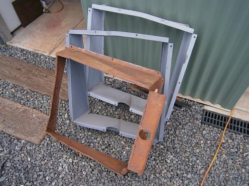

Default Ford Cab 13, Front radiator ducting

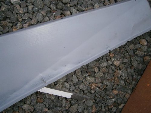

Name:	Front air duct 1.jpg
ID:	49728 Click image for larger version
Name:	Front air duct 2.jpg
ID:	49729 Click image for larger version
Name:	Front air duct 3.jpg
I forgot to mention yesterday, that when I looked over the three radiator ducts I have, they were all less than ideal. With some reluctance, I have come to the conclusion that I will have to make one good one out of two (possibly the three).

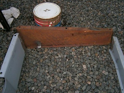

Name:	Front air duct 4.jpg
This is the side I will be replacing. Someone has had a thorough go at repairing this once before......but failed with the welding. I used to weld like that, sometimes still do
Two of the three remaining sides are not too bad and should be repairable without too much surgery. The third side I did some panel beating on last Sunday. It should be OK with a little skim of plastic filler.
God I hate panelbeating
