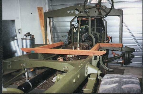

I was waiting for my brother to finish harrowing a couple hundred acres this morning so I took the time to move the rear end back where it belongs. I also cut away most of the scrap iron the other day. It looks a lot better now. I tried the pintle mounts off the F15A and they bolt right on. They look to be the right ones for the C15 too. The only problem is the pintle spring is a couple of inches too short because of the different frame widths. I'll have to get a spring company to make one up for me. It'll probably cost about $50 or so.

Default Towing spring fittment
In our thread on the mounting of the towing attachment it was stated that it isn't the spring that is longer, but that the mounting brackets reach further inboard on the F/C15 as compared to the F/C15A and that the same spring assembly is used for both types. (see posting dated March 10 2007 for a photo) Finding the 2 wheel drive brackets could be enough of a chore to make a new/modified spring very atractive.
See:
http://www.mapleleafup.org/forums/sh...&threadid=7096
Old 18-05-07, 08:06
Grant, that's just what I was thinking. The 4x2 brackets will be all but impossible to find. I'll just have to get a new main leaf made that's two inches wider with the two holes near the ends two inches farther apart too.
On checking out the stuff I torched off the frame I see that the piece with the four bolts that they welded on to hold the hitch is part of the original hitch.
On another thread I mentioned that the axles out of my Maple Leaf 2 ton parts truck fit the C15 rear end exactly. The dash gauges are all good too.
I already had a front bumper and crash bar plus a headlight off a derelect C15 that I acquired several years ago so that helps too. There's a non-folding seat with it also.
