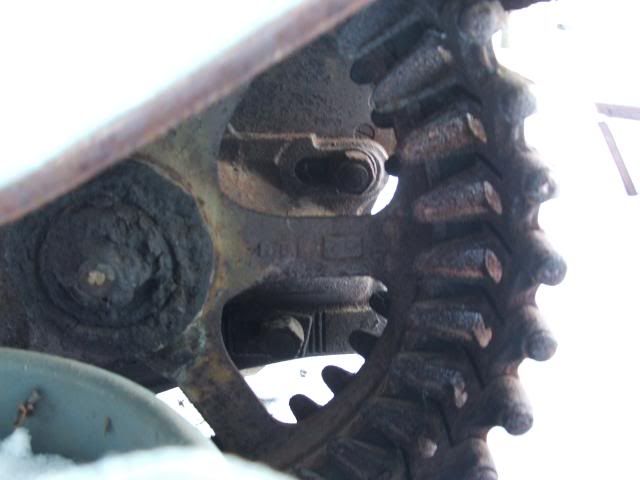

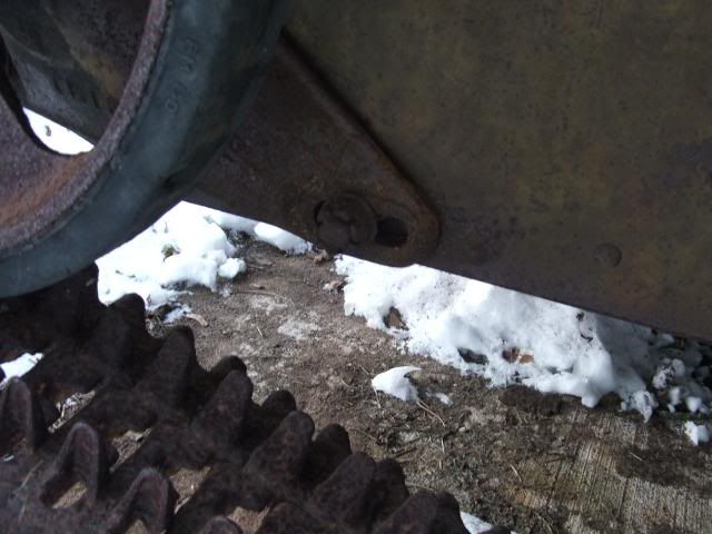

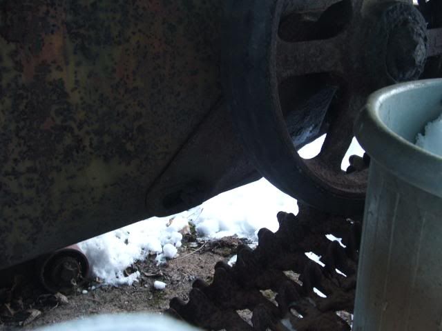

I would guess from those sprockets, that the track is pretty badly worn. when they sit around for a few years the rust tightens them up, and the look pretty good...... In your words "Caput"
Yes new track with new sprockets.

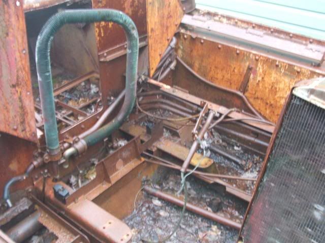

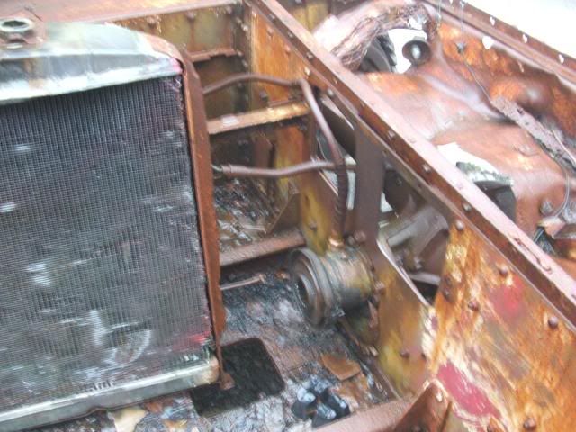

here are the rest of the pics for it, if anyone has any bits they can see is missing and would like to dontate towards the cause please feel free to shout up. I have emailed Dirk a few times to get some info from him but he must be busy, will ring him when in a minute.

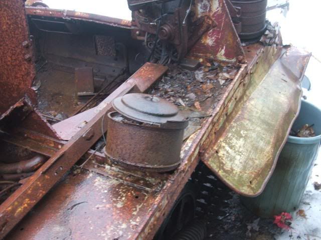

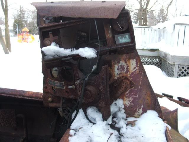

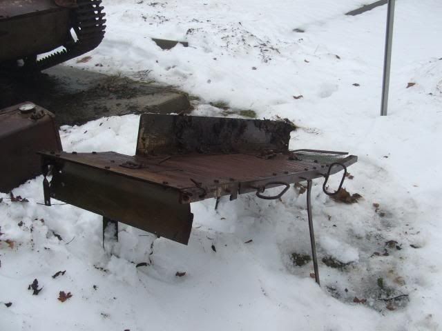

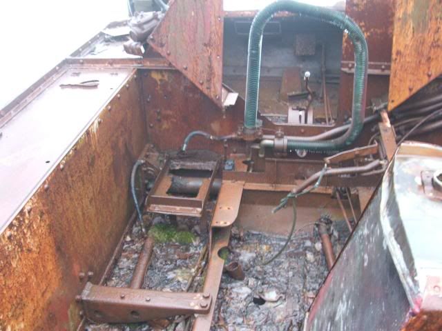

also not pictured but included is the engine top cover, the tank, the rad and shroud.
for sure missing:-
speedo + gauges
switch assembly
hand brake
some linkage peices
armour !
gunners seat.

The real measure for track wear is the angle that the tracks sit on when viewed from the rear, The individual pads should lie parallel to the ground, a moderatly worn set will start to tip in towards the dif. equal wear = equal angles. Worst case is tracks which both tip to the left or right indicating a cobbled set of tracks.
Regardless, you may have as many as 1000 k of use/wear left on a worn set.
You are going to learn - fast- that screaming down the road in top gear and full throttle is a very reckless activity in a vintage carrier (oxymoron I know) when all that is at stake is dismemberment and probably death.
The end state here is that a worn set is not a show stopper. You will find a set later and bolt them on if you need them. Base your purchase on the rest of the machine.

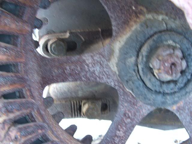

got some pics of the adjusters, it looks like the previous owner (to Rob) has been taking links out and not using the adjuster on the front, they are both set to the rear most point so perhaps a few links here and there and a wee bit adjustment may help matters on that front.....when i get to that point.

I think you will find that taking one link out of the track will shift your adjuster from its out limit to its inner limit. with every thing else staying the same.
Your carrier has a lot of good bits, and although I believe your track is probably 90% though its useable life,you are "in the game" by restoring this carrier, and while going through the restoration,you will likely locate some more.

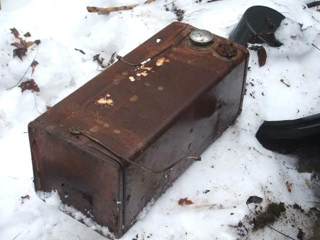

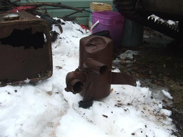

Old 12-02-09, 21:15
RichardT10829's Avatar
Richard Harrison
Join Date: Nov 2008
Posts: 3,069

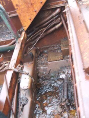

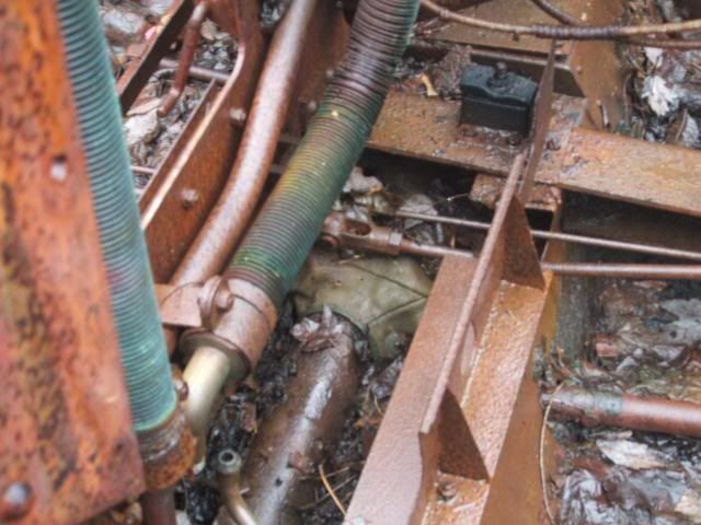

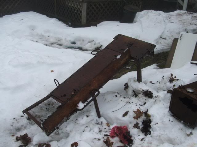

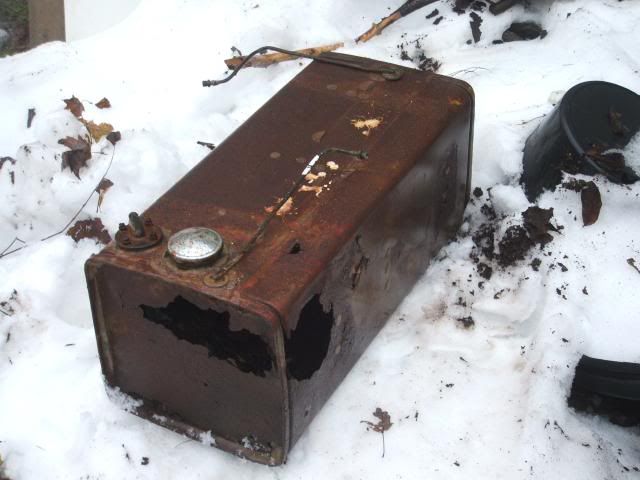

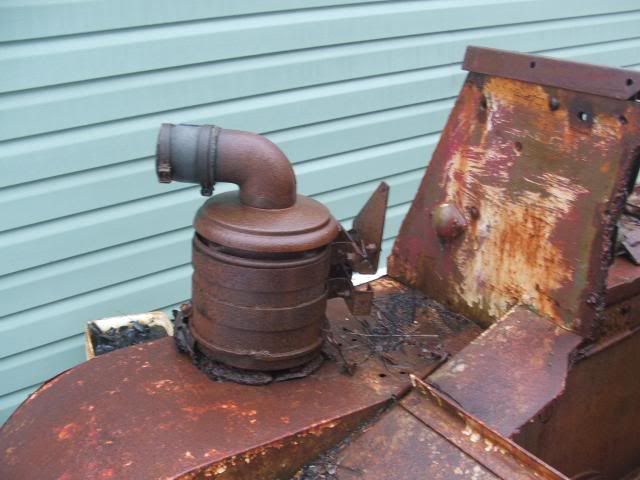

some more pics.
tank needs a few holes plugged up
top engine cover, are the oval loops an after mod or something ?

Old 12-02-09, 23:13
Ledsel's Avatar
Ledsel Ledsel is offline
Taisto Hako-oja
Location: Myrnam Alberta Canada
Posts: 314
Default parts
You have a start. That muffler doesn't belong but the air filter is proper. Just give the carrier a good clean out when you get it and (DO NOT) throw any thing out until you are finished with the restoration. Good luck.
P.S. What you should do when you get it is tow it around a field or somewhere for a bit, just to loosen up the track somewhat. It makes it a hell of a lot easier to work on and to replace them when they are a bit pliable. This is an Ontario carrier so I have a lot of experience when it comes to anything rusty.
